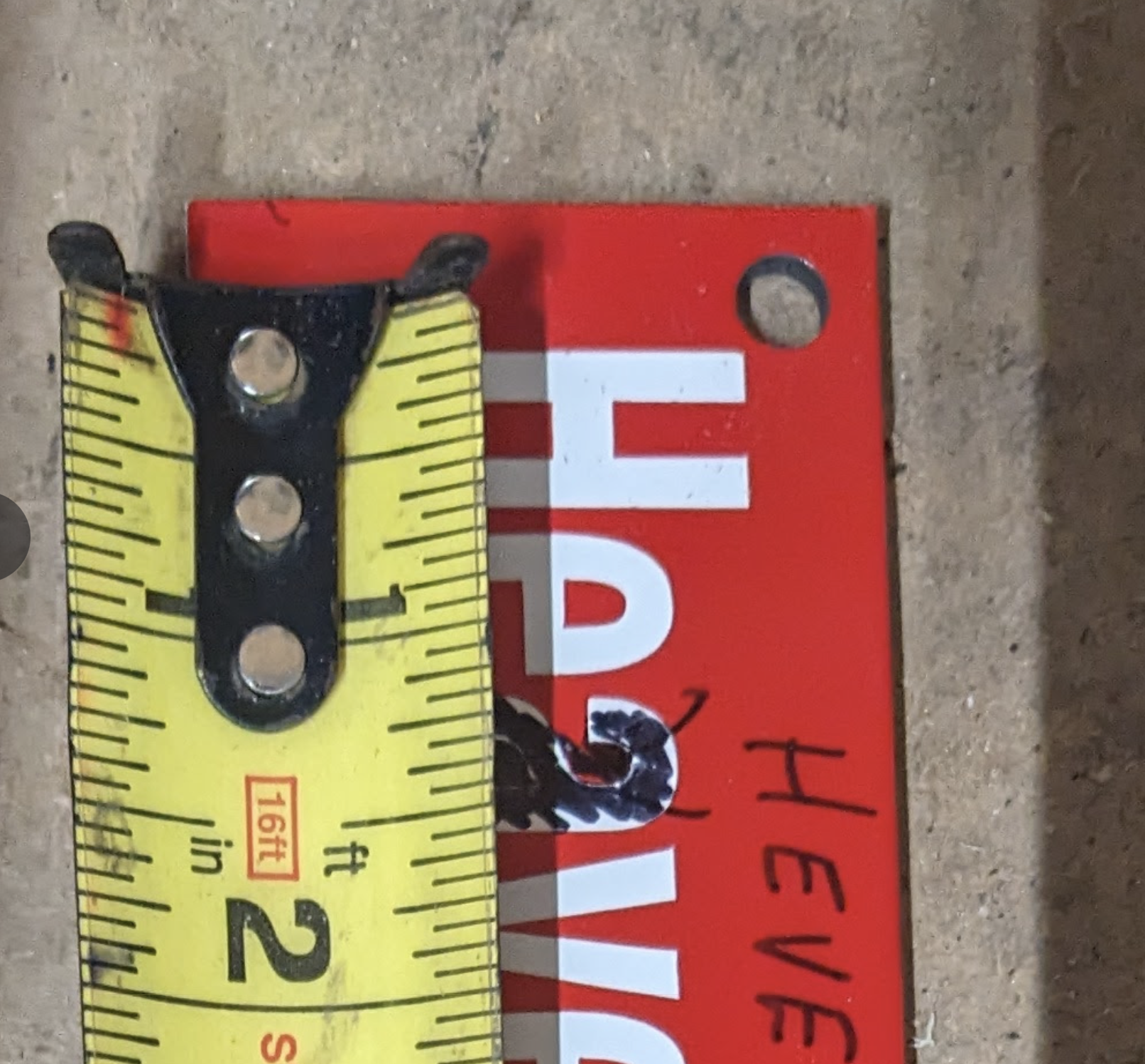

Let me ask you a couple questions about it - I'm going to be putting the holes in 2 corners. My plan WAS to set up a 2-sided, right angle fence on my drill press and just shove the piece into the corner of that block, drop the hole, flip over for the second one and then move on to the next one. I've got about 40 of these pieces to do.
1) Do you think the hole is too close to the corner to punch? (I'm worrying about delimitation or bending of the narrow pieces between the hole and edge)
2) Can I somehow modify the alignment gauge (maybe add another piece?) to make it line up to a corner instead of just a depth? It would save time of having to mark and align them all.
3) (I lied) it looks like that has compound leverage so not toooooo bad, will my hands survive doing 80 holes? :confused:
Regardless, I'm definitely going to get one of those because it looks handy as hell for all kinds of other things. Good link!

weyandsign
1: No, the hole is not too close.
2: I would be interested in finding a tabletop mounted version of this. It is a little awkward unless you have the pieces held down. You need both hands to operate the tool while holding the piece. But it's not too difficult.
3:Yes your hands will survive it punches thru very easily.

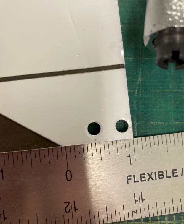

Thanks for that visual it helps a lot!
