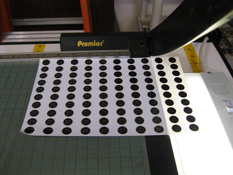

My Premier paper cutter allows me to trim out labels, decals and text readings quickly and on the square. And as a supplement to that, we keep a low profile fluorescent light to the right of the blade to easily see between lines for accurate cutting.

Nothing worse then cutting on a shadow.
I wouldn't term it a shadow. The light shines up through the release liner and shows a very clear line of where the edge of the lower blade is at. Been doing it that way for over 20 years now with near perfect results.
I meant when the light isn't correct and the finger protector projects a shadow so you can't quite see the cut line and you just cut a shadow. I have a light hood that I move lower to the table so I can see clearly. I like the idea of seeing the bottom. Next time I'm gonna try to flip the light over and use this technique.

Actually I cheated and just grabbed a pic off the internet. I'm also a bad, bad boy and removed the finger guard years ago. Here's a shot of my trimmer with the light.
