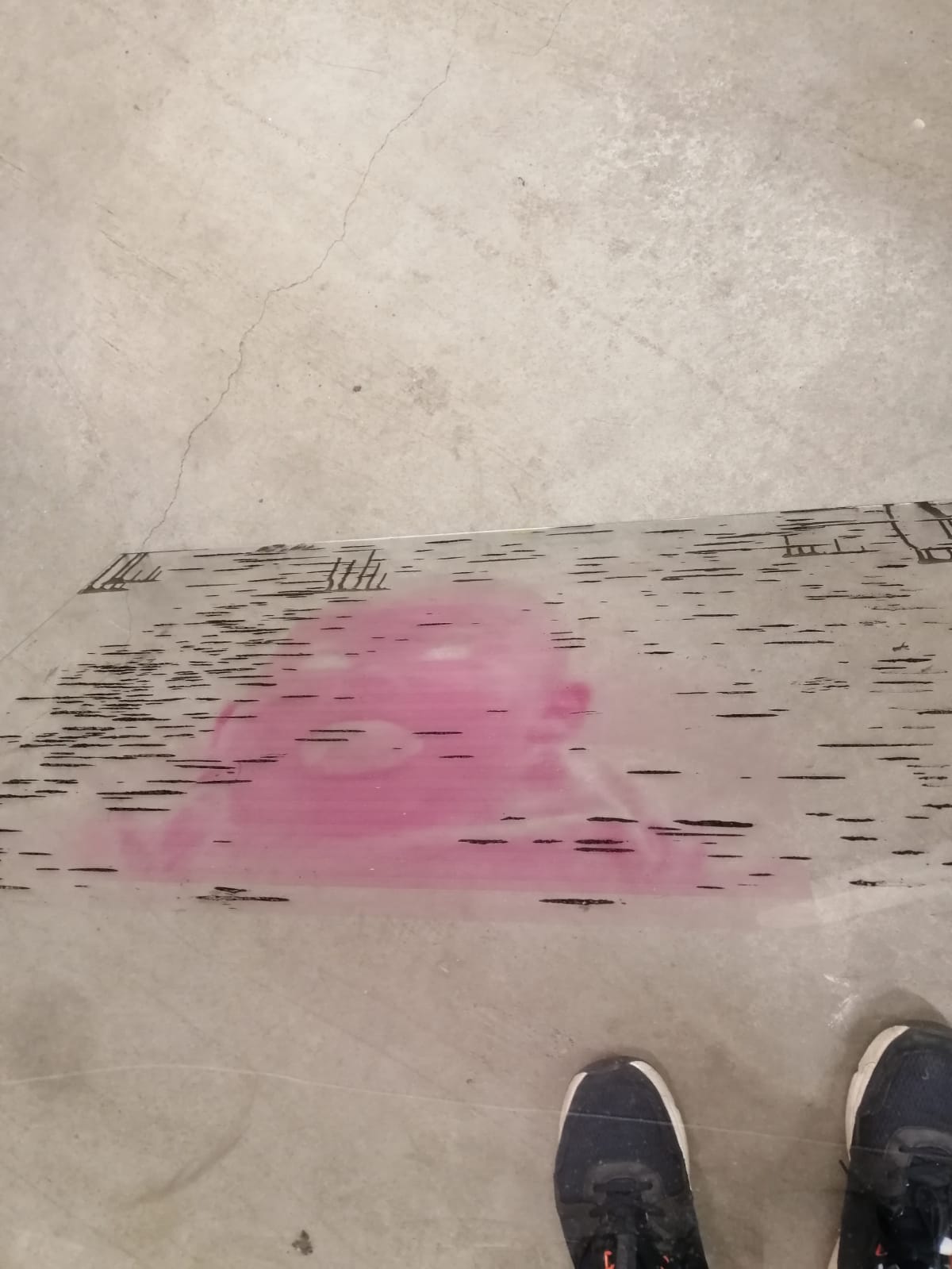

since yesterday we found out how to use our server pc for colorgate,
the settings is as good by the previous owner,
Only now we tried to print a .jpg and .eps photo yesterday, only we got this image, see image,
the photo is a normal photoas you can expect from a photo , only now we see pink and black stripes everywhere
I hope you can help me I am new in it

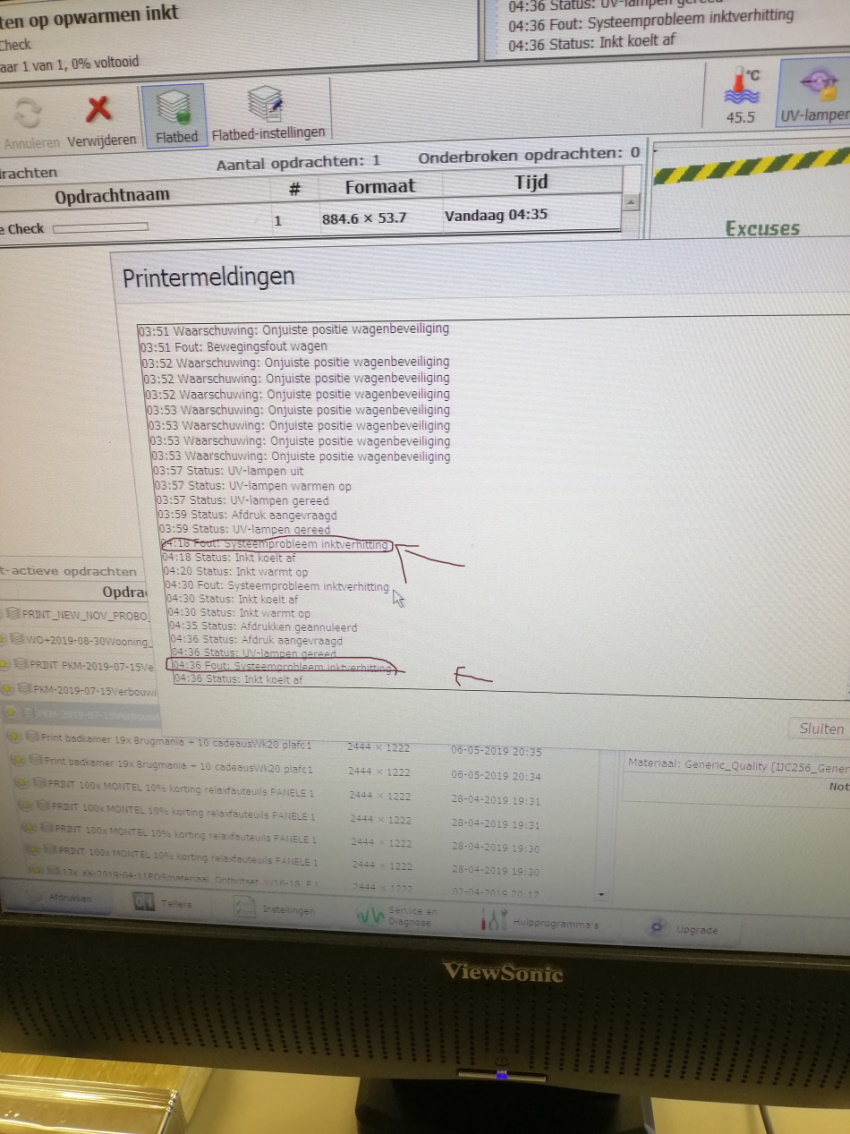

I wanted to do a nozzle check yesterday, the device prepared a view such as heating ink etc,
but at one point I got an error message from system problem ink heating, but before that it had printed without problem
see the picture i just had

Anony007
What does your nozzle check look like
yesterday I did not manage to do a nozzle check, when heating the ink I got problem of system problem ink heating,
but before that we managed to do a nozzle check

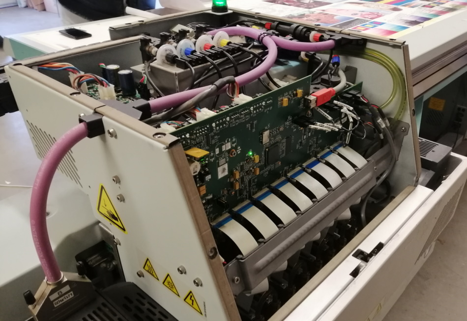

The valves are in the correct position for print... however is there any ink in the round filters? It looks like there might be some in the blue filter which can cause the inks to bleed all over the prints like your first photo.
What temperature is it in your print room/workshop?
We get this problem in winter when <18C. We just press the heater back on and it eventually warms up properly.
How are your coolant levels? Check other side of gantry. There is a level hose which will show you. Needs to be half way at least for proper ink heating.

us shop its verry cold we dont have any heating there i think us shop is probarly -+ 7C degrees celcuis (europian degree) in fahrenheit 44,6 °F
dont have any heating there, its very cold prr,
I have not seen a coolant level, but I probably see a cable in the coolant but where I can watch the level
I'll check tomorrow if there is any ink on the filters

You can check coolant level here. Should be half way up the tube.
7C temperature should still be okay. You might need to turn on the heaters 2-3 times before it reaches printing temperature. Just watch the control panel carefully and as soon as it stops heating, turn it back on again. On a 10C day here it can take up to one hour to warm up fully.
