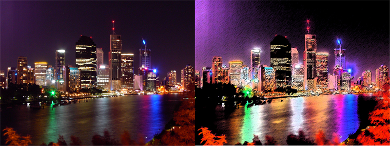

I would start by using Sumi-e -
Here is a side by side comparison - the original image, and then with Sumi-e filter, without modifying the default filter settings at all.
Filter>Brush Strokes>Sumi-e
