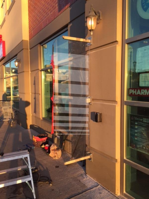

Here's a picture. These panels should be pretty much invisible at night!

Yea those should have been edge lit from the back with led so that the light actually lights up the panel. That's just waiting to get hit.
Yup... looks like a lawsuit waiting to happen. There is nothing on the panels right now... the strips in the photo are just Photoshopped in.
I've sent my idea off to the contractor that installed these. I can edge light them from the back edge. I called Luminedge and the fellow says he can supply waterproof strips so problem solved. Thanks for the posts.
BTW... I discovered that window frost lights up just like laser etched plastic. A lot easier that taking the panels down to laser etch them.
