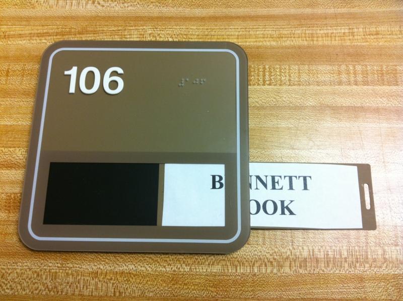

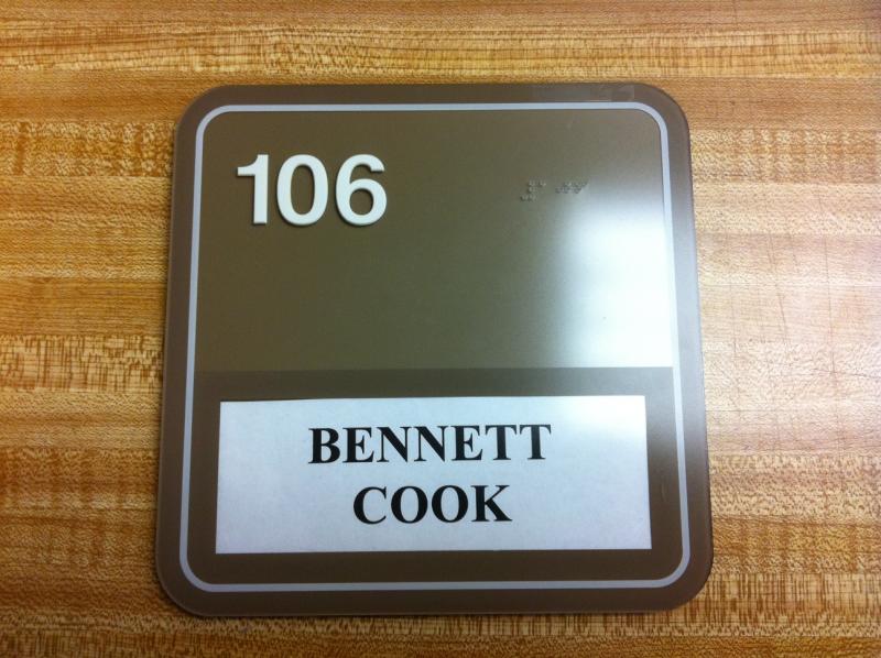

Had a customer bring these in to me. He said that they need like 10 of them. It's a big place with probably a couple hundred rooms in it. They have braille on them and the name mounts on a little sliding piece that comes out from the side. He said some of them are double stacked, and you can put two names in them.
No idea where to start on this, I googled it, but didn't come up w/ much cause I don't know exactly what it's even called. It's got no engraving on it. The numbers are raised, then it's got like a sheet of plexiglass over it or something, and the color is under that.

anyone who does ada signs will be able to duplicate these for you...i've made thousands of them in the past for retirement homes ( so that they can cheaply change out the names when 'residents' ... 'move on') it is just non-glare acrylic that is backpainted (usually with lacryl) that is adhered to a backer (usually 1/8" black acrylic) leaving a gap for the "slider"

That is an Interface sign, they are out of Atlanta. A company called Kroy Signs out of Phoenix does similar work

We have done those inhouse using acrylic, and aluminum. Of course we talked them out of raised lettering, once they found out how much cheaper it was they went for it.

As you have a sample in hand, it is pretty easy to duplicate, a great chance to snap that account.
Get the two layers of acrylic, find a local engraving shop that also do braille, send the top matt-clear piece for them to do the raised number and braille, shouldn't cost more that $35 on that part.
We will charge $75 for that so you can start servicing that account and pick all other signage.

Since this is a code sign with required raised elements, this may not be the best advice. In a few states, these signs are part of the actual building code so a sign shop would want to avoid giving the client the option of taking off the raised lettering and braille.
