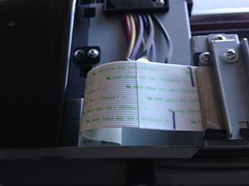

Is this the encoder strip?
threeputt
No. The encoder strip is a long clear strip, about 54" long by 1/2" high. It has barely discernible lines on it. (you'd have to look very, very close to see them). Remove the top of your machine. You can't miss it. The cutting head and print head moves along it as it travels back and forth.
