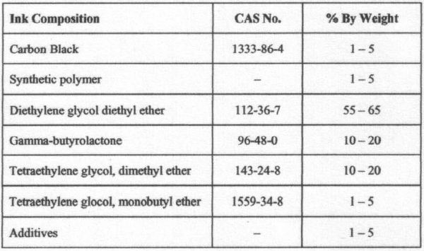

Since we are getting technical, I wonder, is it really a single liquid and can be classified as a solvent or is it two or more chemicals/components and should be classified as a solution? Mutoh's website calls it Washing Liquid and according to the MSDS it is a composition of one chemical and multiple minerals so I guess it really is a solution...
Stealth Ryder
It is the ink without the pigment, kinda like paint thinnner to paint... It is considered and commomly reffered to as an Eco-Solvent.
Stealth Ryder
The MSDS for K is attached
