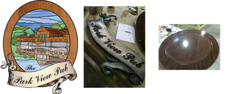

pub sign.jpg I am trying to decide which type of canvas or textured material to use. Had another thread about this so sorry for the double post. I will be mounting the scene onto the wood frame (painted hdu). I want to use a canvas material or maybe a wallpaper material. I plan on brushing clearshield on to add brush strokes. I would like to hear what others would suggest for a material and how you would apply it to the frame. I have been looking into magiclee GFCVM Acid-Free Matte Inkjet Canvas, and phototex. I like that phototex is adhesive backed. How would i mount the canvas, wallpaper glue? Also after i have the print mounted to the frame I was planning on taping off a narrow path around the edge of the canvas and frame, run a thin bead of caulk to hide the edge of the printed material. Does that sound like a good idea? I am printing with a roland xj540 eco sol max ink

Nope - get an acid free spray adhesive, or do what we do. I buy foamcore from Culvers that already has an acid free heat activated adhesive on one side. We have a framing press so we just put the print on there, press it for 90 seconds, and it's ready to trim out and use.

I dont want to have to add in the thickness of an extra substrate. i've used 3m super 77 spray adhesive in the past but pretty sure that is acid based. What acid free adhesive have you used in the past? Do you think the adhesive is somewhat slideable like wallpaper? Wondering because its hard to imagine laying the print down perfect.

Jhill, phototech have either of you ever used a spray adhesive to adhere canvas to painted hdu. If so which product did you use? Were there any pros or cons? Did the adhesive set up instantly or was there a period of time that you could slide the canvas around to line up properly? Or was it a one shot deal?
Also still wondering about a small beed of caulk on the perimeter to cover hide the seam between the canvas print and painted hdu.

Seriously? what the heck is wrong with 3m spray adhesive, it's acid free and will stick wallpaper to an elephants ***.

If you're looking for a spray adhesive that will hold 100% for years on end with no issue with just the adhesive alone ... won't happen ... they all brittle or die with age and exposure. since the canvas will lay flat into the frame ... why not just flood the surface of the canvas with a urethane coat like a bar top? You know, the ones they embed pennys and photos into. It will preserve the canvas forever if it's solvent based and the urethane will have to be chiselled out to take the print out.
Signed Out
Tyrant I like the idea to flood the frame with polly. will probably go that route. this may be a dumb question but I shouldn't need to clearshield the canvas before I flood with poly, should I?
