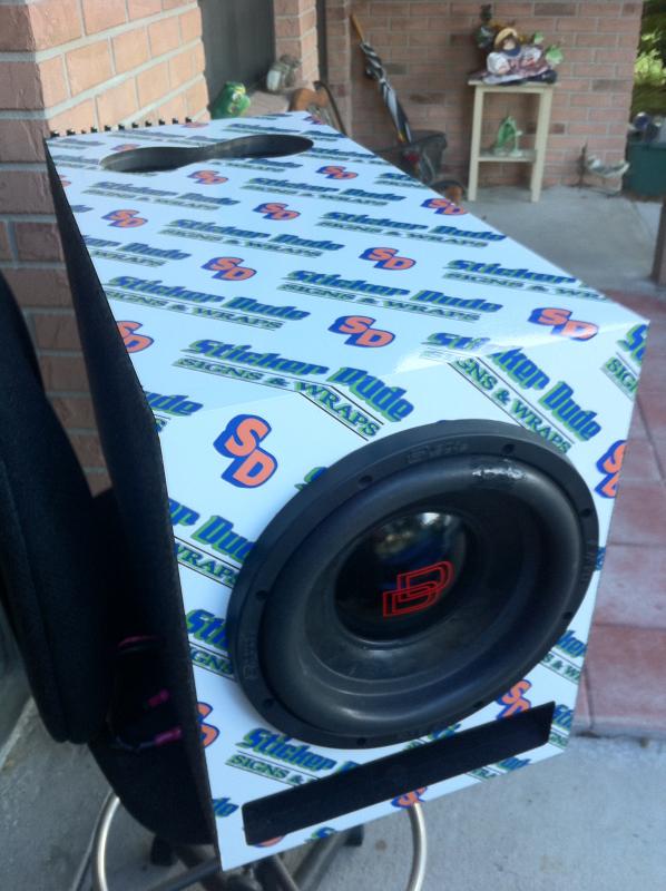

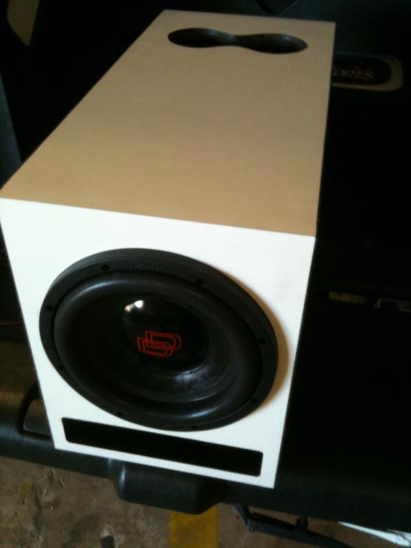

so you mean something like this
the box had formica around it then wrapped it in 3m with 3m lam
Do not use 651 that vinyl will shrink within months (I tried) use vinyl for printed media for wrapping
