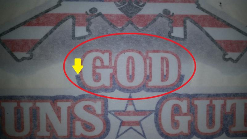

Since Flexi has been running on this newer system, specifically the transparent shadow over any object/s prints a White box instead of what's under it.
Now on this new system flexi asks to raster the image before sending. Does not matter about the resolution, the end results are the same. Never had to do that on the old setup, is there a setting I missed. All art that is being sent is vector, looks fine in production manager too.
I've attached a picture to better explain the issue. Yes I can just flatten the image but curious why it's doing this on the new computer.

Yep I was just going to say that the image is part raster and part vector. It's a transparency issue for sure. I rasterize everything before printing if it has drop shadows and the like. Looks clean and no "UH OH's"..

set rendering intents the same for both raster and vector in the RIP - the shadow is actually raster and not vector.
on the bitmap option under rendering intents it's grayed out, text and vectors are the same intents.
What am I missing..
