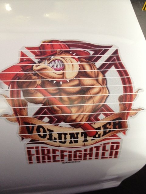

I bought a used falcon outdoor jr.
The nozzle check looks great but everything I print hooked to my pc looks like the picture below with these perfectly spaced white lines.
I am using a new dell laptop with win7 and flexi 10.
I really need to get this working.
Please help!

Not sure on yours but mine prints the solid colors in 1 pass then moves forward for the angled colored bars. So, the nozzle check would still look good, but there would be extra room between each pass if Step was off.

In the user menu there is test print (not nozzle check) if I am not mistaken. I have no access to the machine now to check. It is a test with color blocks and circle and fonts printed. Try this first. As mentioned what RIP are you using?
The more and acurate info the quicker answers can be given.

looks like you are using an un-licensed copy of flezi.....
Is the security key plugged in and lit up? is it a registered copy?
Yep - running in demo mode - gaps added to all output so that it can't be used for production.
