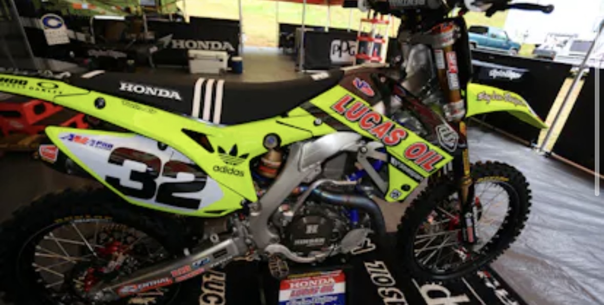

Hello guys,
I have a Epson S80600 with white ink.
Print on fluorescent foil is no problem, but it’s always not 100% opaque on the Fluo foil… with clear/ holo it’s no problem.
My question: Is it 100% opaque with a Mimaki UV or Latex on fluorescent foil like in the picture?
Best regards Alex

Latex can produce this white opacity on fluorescent film when using 160-percent ink density (this is not the highest white ink density possible). It is far more opaque than any eco-solvent white ink, and is comparable with or better then UV inks in that respect.
BigNate
coming from offset printing the saying is "There is no such thing as opaque white" meaning anytime you print white it will always have some transmittance of light (but they do sell it as "Opaque White") - you just plan on it in the design so the minimal transmittance is not a dominant feature.... printing 2-sided window clings on the 700W I can still take a mag-light and see it through a solid black/white/solid black printed onto clear cling.... If you doubt, take the best "opaque white and smear in thin over a sheet of Astro-Bright and see how well it covers - even in a very thick layer. or try printing white letters onto a color media.
White ink is a very useful tool, but it is not perfect. I do agree the latex white seems more opaque than others I have used, and it should make a good sticker on fluorescent media.... but if you print only white image and leave a reference next to it that was printed on a different background you will notice the difference as the white on the fluorescent media will show a few percent of transparency....
to the question: "My question: Is it 100% opaque with a Mimaki UV or Latex on fluorescent foil like in the picture?" No it is not - and without first hand vision of the stickers on the bike - my initial thought is that the design of the high contrast bold colors on the bike will hide quite a few percentage points of transparency and you would not notice it... regardless of content, the colors/borders/gradients will hide this much better than trying to find a slightly more opaque ink.

yeah, but unless it is all but light proof, you can see a difference on different substrates... the prints can be made to look awesome.... may point, going back the the OPs original question about there being 100% opaque white on the fluorescent stickers on the motorbike in the picture - the bike does not have 100% opacity under the image and over the media. The designs uses good contrast and colors to make it so the lack of perfect opacity is not an issue.
