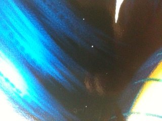

The only issue I have right now is the white spots. I have attached an image with a sample print.

personally, i don't think your machine nor your media has anything to do with your problem - since it happens so randomly.
my first guess would have been fish eyes. but since you ruled that out, the only other source i can think of is dust getting onto the media - getting printed on - and then falling off afterwards, leaving a nice clean white spot.
how about you give us a better magnification on the white spots?
