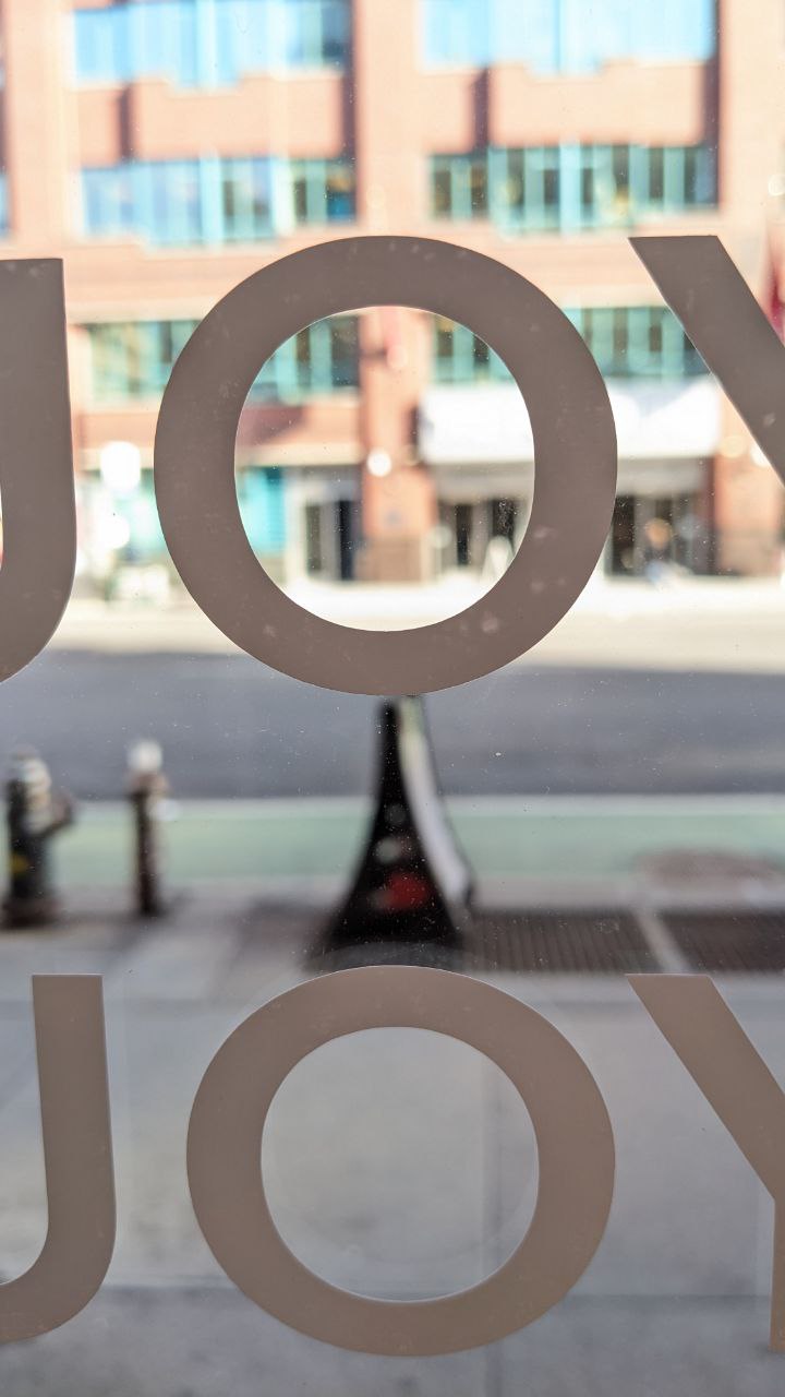

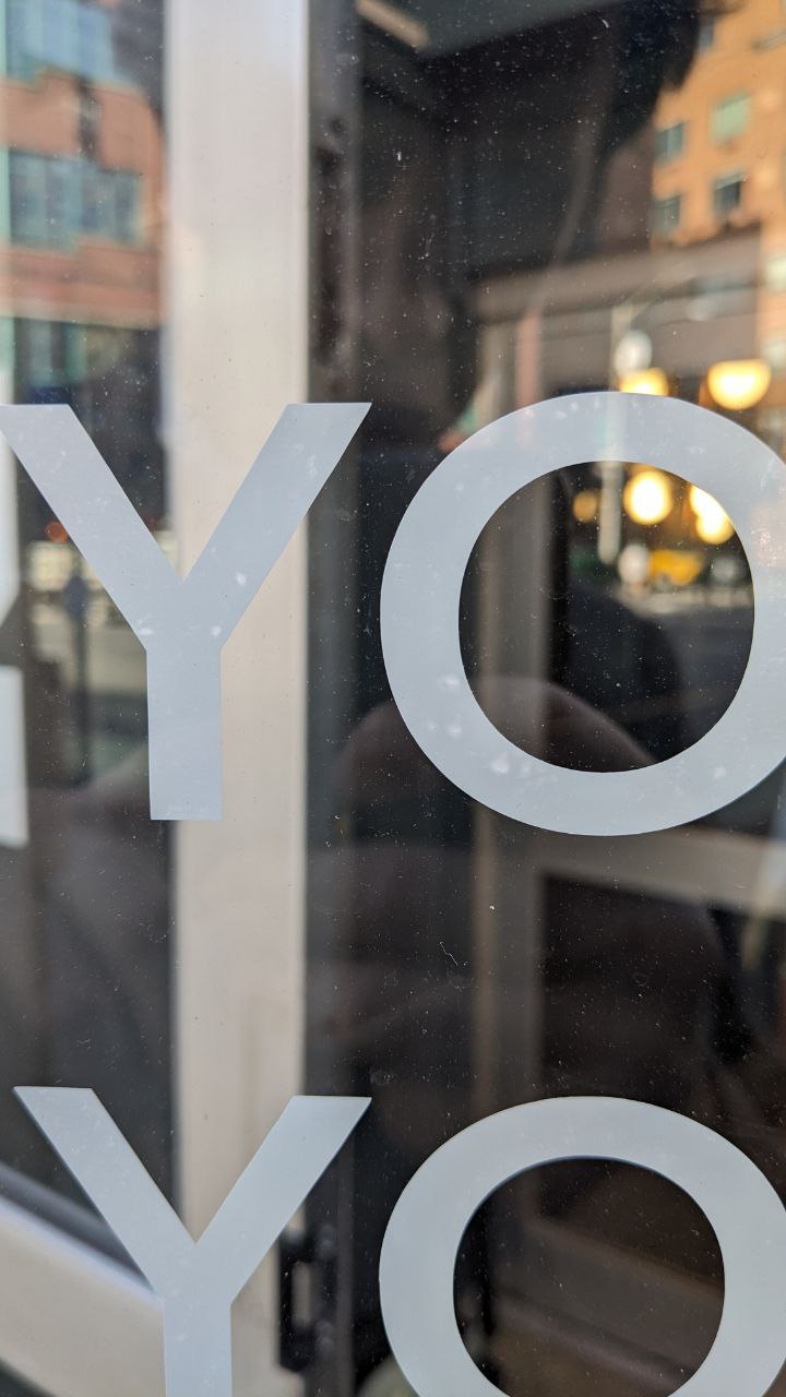

Hello forum. Is there a white vinyl with air channels and clear adhesive? We use Oracal 651 for glass, and when installed on second surface you can see little bubbles.
I was told 751RA will work. I haven't tried it yet.

Drytac has an awesome 6mil white with clear removable-to-permanent adhesive and air-egress. The thickness makes it a breeze to apply....it can also be applied down to -5 degrees Fahrenheit.
Notarealsignguy
Arial - it's almost helvetica
The description says the adhesive is light grey. I'm looking for the material that is white on both sides.
It's clear and believe it or not, 100% opaque. After using this material for a few years, I prefer the clear adhesive over gray.
