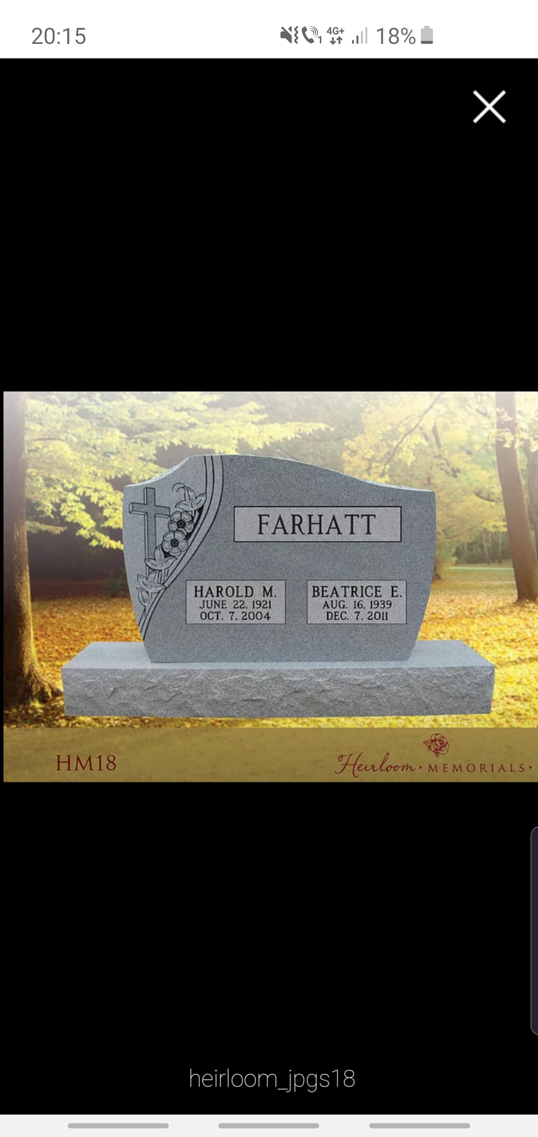

I have the monunent and the vector to.How to cut with plotter to have the white black and the grey colours too.Thanks in advance..

You'll cut the entire design in the stencil and remove the areas that need to be "frosted" (made white by sandblasting with a coarse abrasive or steel shot). The process of frosting the granite is also known as "flashing" or "steeling", depending on where you're from. The surface of the granite is fractured, thus removing the polish and revealing a surface that sparkles. If fine abrasive is used, the frosted areas appear dull and do not sparkle.
After the granite has been frosted, you'll apply the rest of the stencil and cut (sandblast) the areas that appear black. That is called "double process".
A quicker method called "single process" is when the entire design is sandblasted at once and painted. Stencil in the frosted areas is removed and the lettering and designs are packed with a fine textured mud or clay before the panels are frosted. Packing the deeply engraved lettering and designs with mud prevents the sandblasting from removing the paint.
If either of these processes are unfamiliar to you, then you may want to sub it out to a monument company.
Ron Clamp is the widely known here in the states for memorial training. He offers training for both basic and advanced sandblasting skills.

Thanks Man.Have to cut with contour cutting?Have a chinese plotter.
