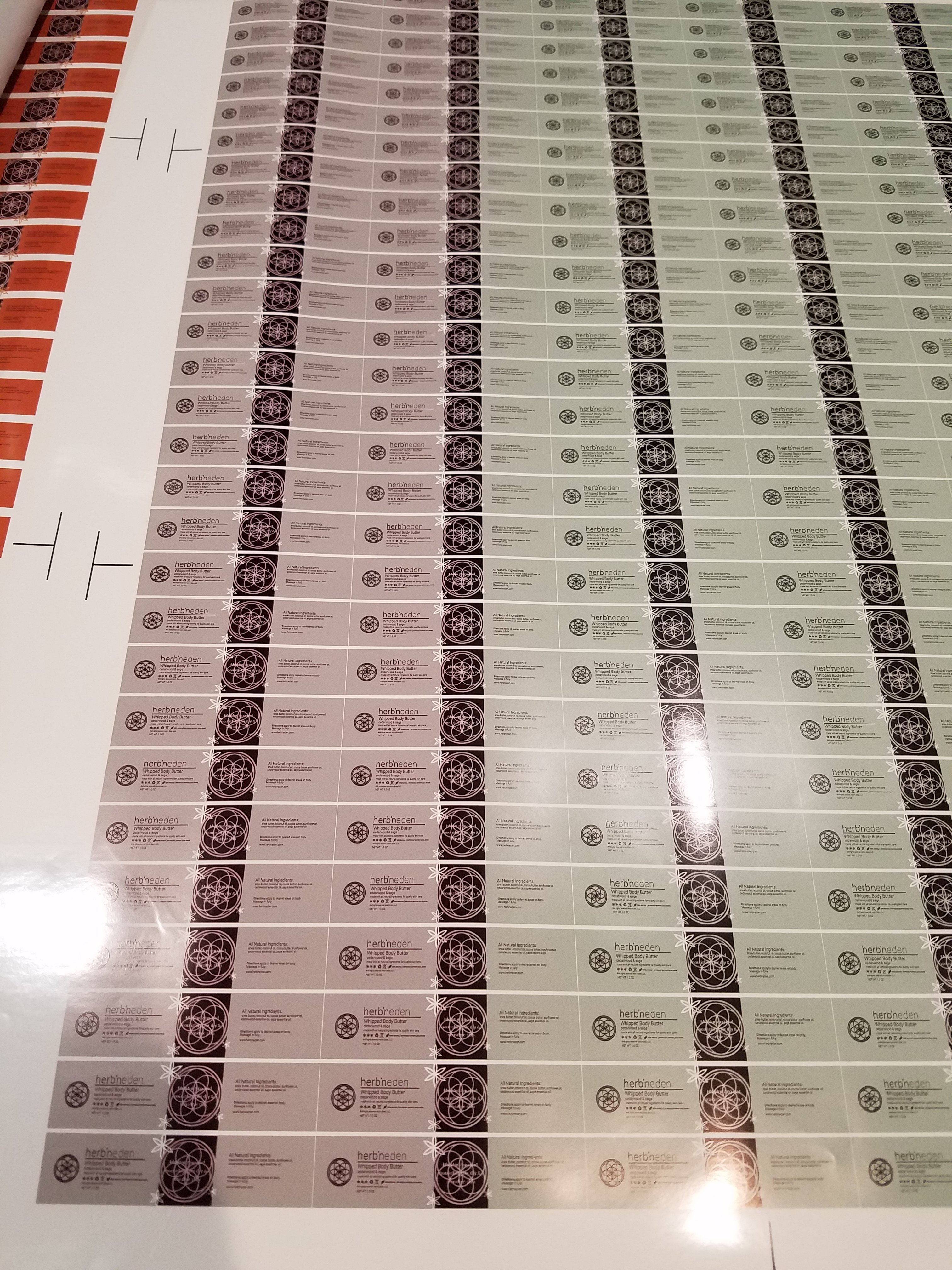

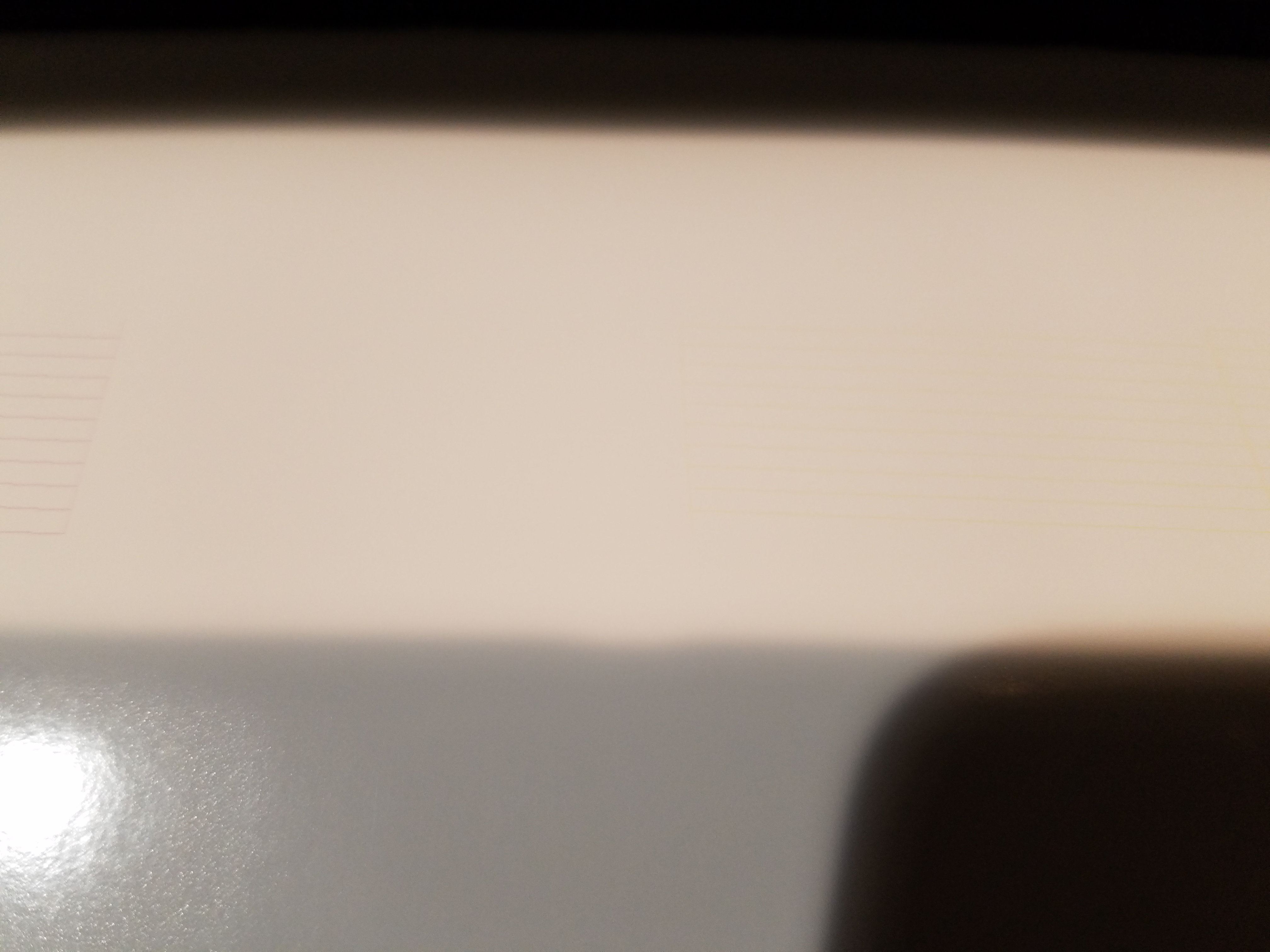

Hi All - I need a little guidance please. I installed a brand new oem printhead in my 1204 a week ago (maintenance station oem about 3 weeks ago). Since installing the head, I haven't printed a ton but enough to keep things moving and it has performed very well. Today however, as I was printing labels for a client, the colors changed mid-print (proper color on left) and I discovered that there was an issue with magenta. Ran a nozzle check and all blocks that printed were perfect however an entire block of magenta was missing. What's the most likely cause please?
