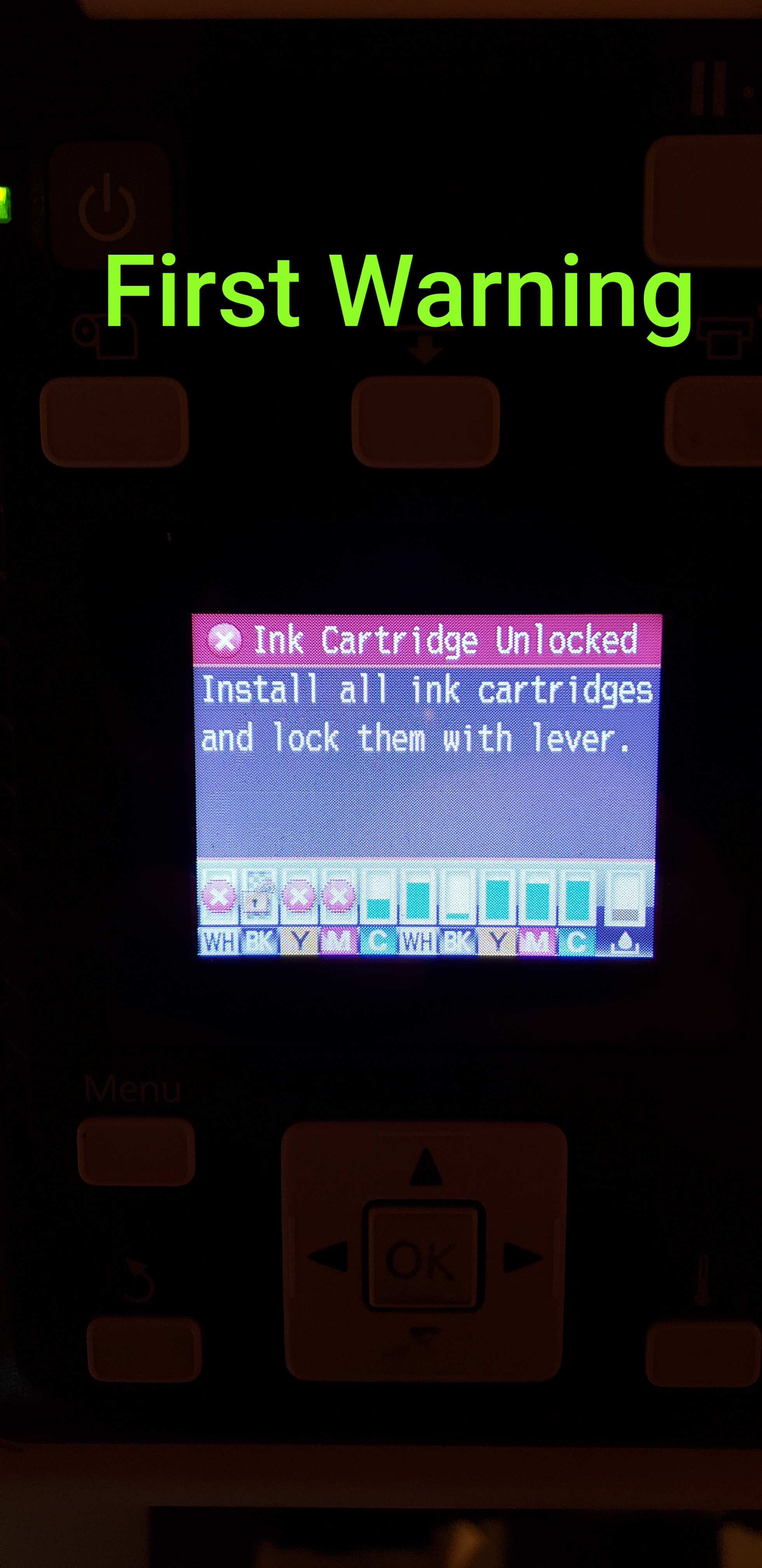

Hello,
I'm in need of some help...who's familiar with Epson Surecolor S50670 ink system? I'm having an error message pop up saying an ink cartdridge (black) is unlocked, when it's clearly locked. This is all that comes up on my screen and I can't get past it. It finally got past that screen now its saying the white cartdridge needs to be locked or something. I'm wondering if the lock levers are just shot? I'm hoping I can make a fix without a servicing. Thanks for your time.

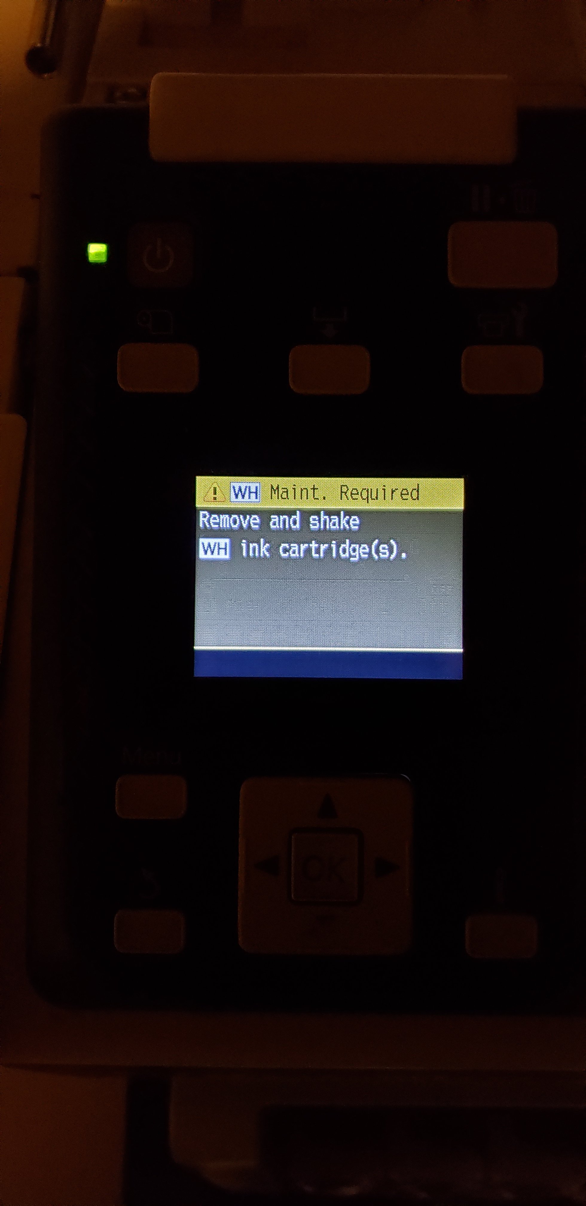

Are we looking at the same photo here? It's asking you to perform maintenance on the white tank, which involves removing the tank, shaking for 10-15 secs and re-installing.
Have you actually done that part yet? Your post doesn't seem to indicate.

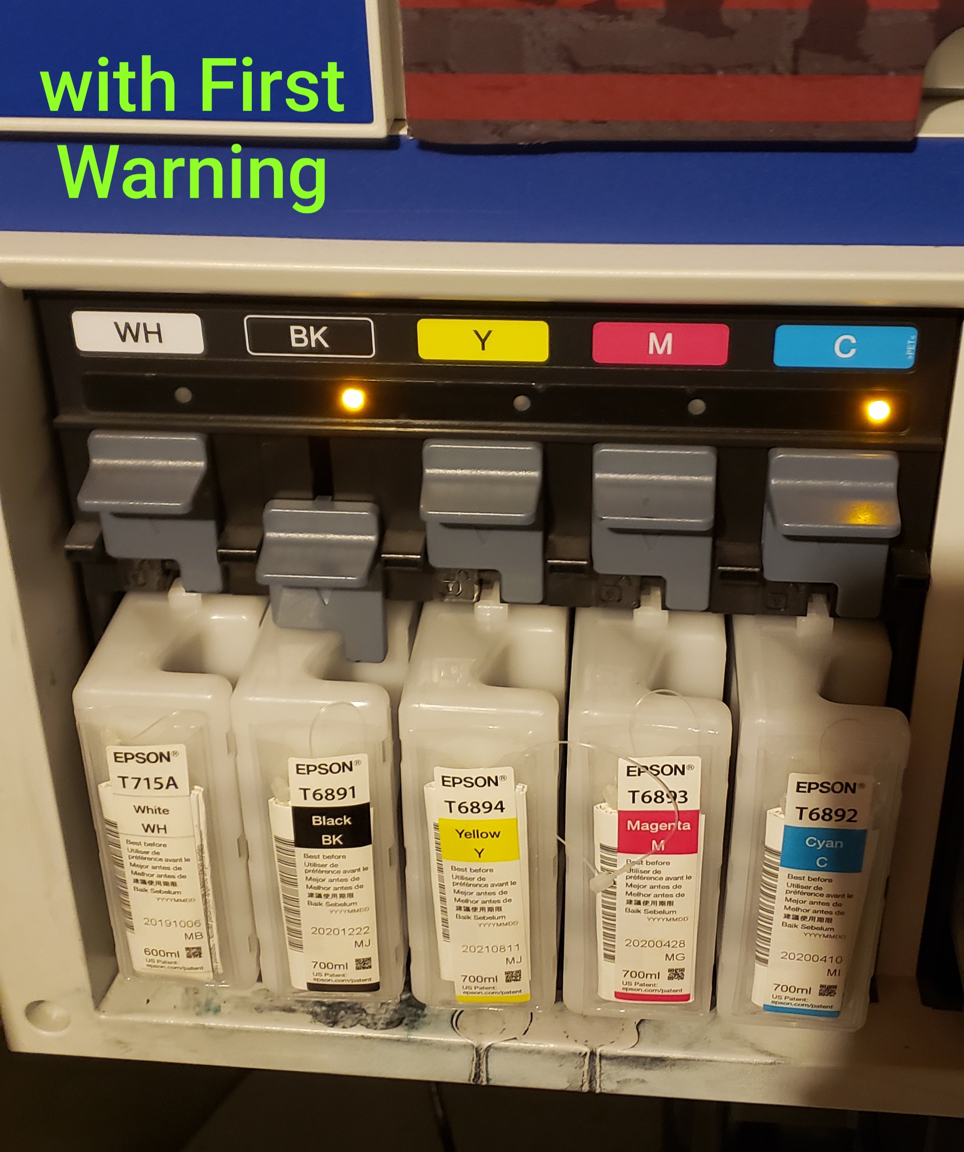

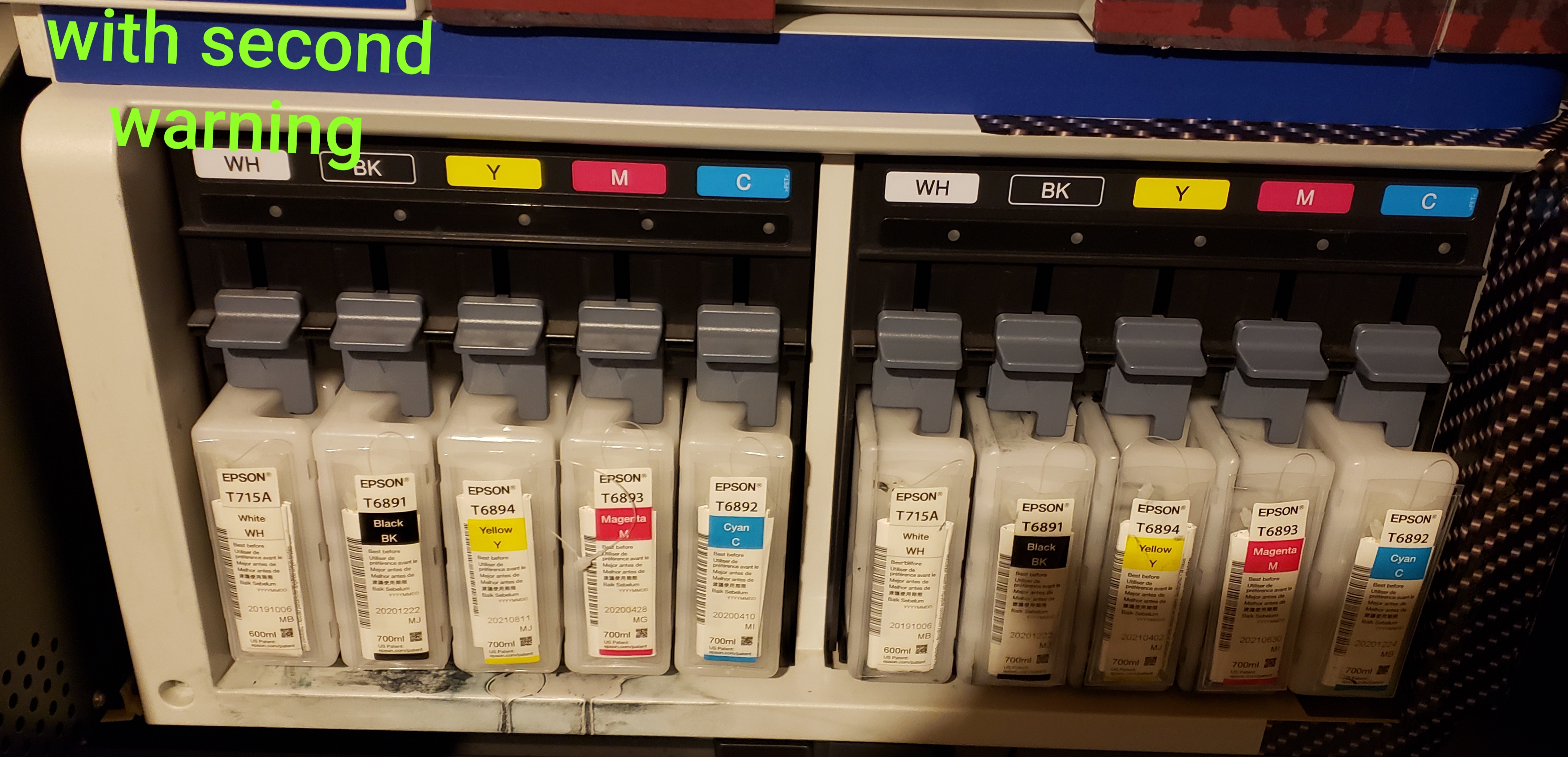

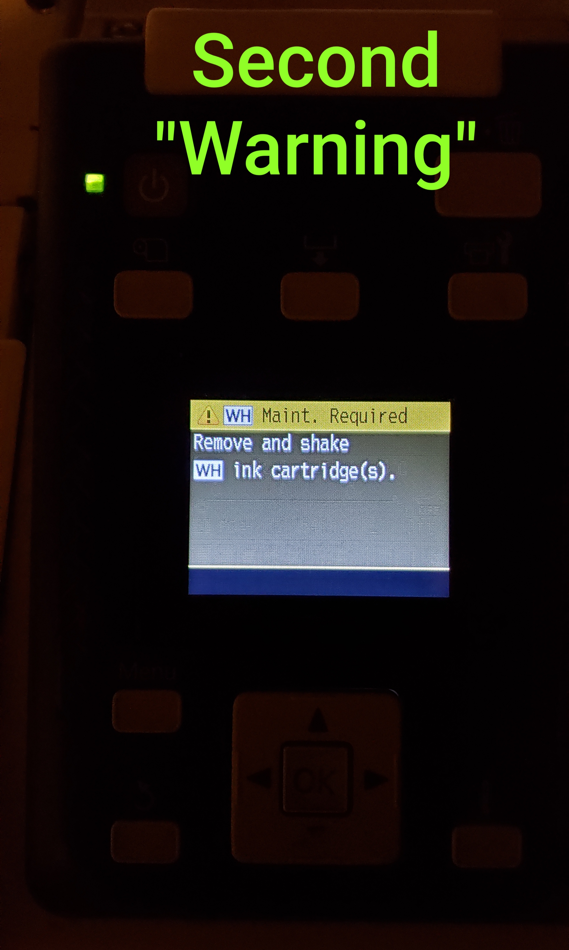

I apologize for lack of information. I typed it up real quick on the run. So the first error/warning was I thought in regards to the black ink cartdridge because it wasn't reading that it was locked and even a couple others as you can see from the photo other then the cyan on the left side. Then somehow it randomly got past that screen the other night and it has the white warning / maintenance message. And yes I've tried doing the usual shaking of the white cartdridges and still can't get past that screen. Its all happening on the left side. Hopefully the pictures kind of help out explaining. 20191220_203259.jpg 20191220_203547.jpg 20191220_203642.jpg 20191220_203759.jpg

For the first issue, there is an absolutely tiny piece of plastic which the printer uses to determine if the latch is closed or not. It's like a $1 part, but rather difficult to get to (entire control panel needs to come out).
We've replaced one after the printer not seeing the grey tank being locked into place. To be honest, once in the area the problem was evident.. not broken, just askew. A tiny poke with a screwdriver would have sorted it, but we put the new part in anyway.
You may be able to get around it by repeatedly opening and closing the latch quickly a couple of times (but not forceful). The tolerances on the part seem to be quite wide so I could see why it dislodged.

Unsure about the WH maintenance happening now though. I'd try removing the tank, rebooting the printer then re-installing. If you have a spare WH tank, I'd also try inserting that to see if it gets around the warning for the time being.
