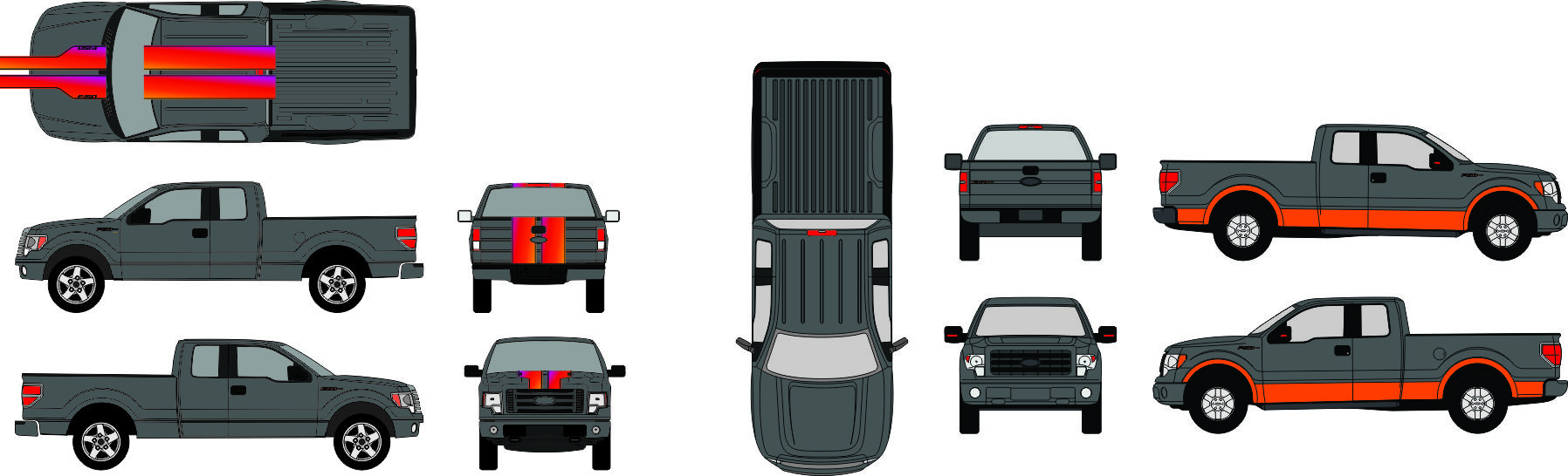

I got used to using templates before wraps were even possible. We used them to show customers the scale of cut vinyl graphics on their vehicle and then price the jobs. During that process I learned how to deal with the discrepancies. When wraps came along it was fast and easy especially if you kept a majority of your design vector based.
After all that experience It always seemed like a lot of extra work to take high res images of all 4 sides, create masks, and lens effects. and deal with each side separately. In Corel I can design with all 4 sides in one file.
Image attached is working in Corel with 2 full size version fleshing out ideas for a color change.
