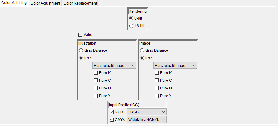

So here's what it looks like to me - I've actually never changed anything in here. The two (illustration vs image) don't appear to be in disagreement, however.
That looks like it should be working fine then. It must be something different. I'd be willing to bet it's a color input or output profile though.
