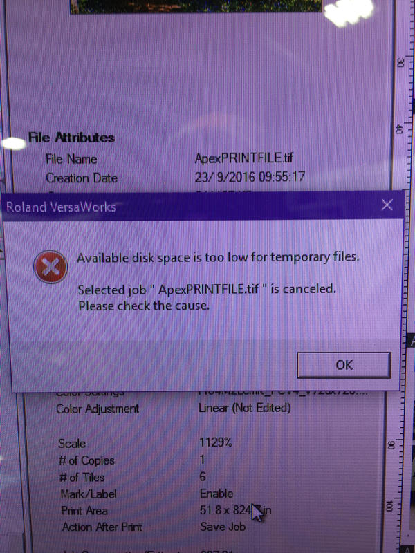

Why does Versaworks keep giving me this error?
wabam
How do I fix it? How come my other printer doesn't do this? WTH?
PLEASE someone help me with this annoying error!?!?!
--see image--

Hard drive is too full. You need to clear space. If you have a bunch of jobs in versaworks, delete the ones you don't need. Or get a bigger hard drive.
Phenex
I agree Hard Drive full. If you are using Windows use the disk cleanup tool. You'll have plenty of options for what to get rid off.
In Win 10 type Disk Cleanup in the search box, then launch the app.
If you have never done this, you'd be surprised how much space gets eaten by various programs and updates. Also, don't forget to empty the recycle bin.
[SUB]I run VMWare for mine and had this issue as well once, you can manually go into JOB A-B Folders and delete files. But make sure you have a decent amount of HD space because when it RIP those files can get big.
