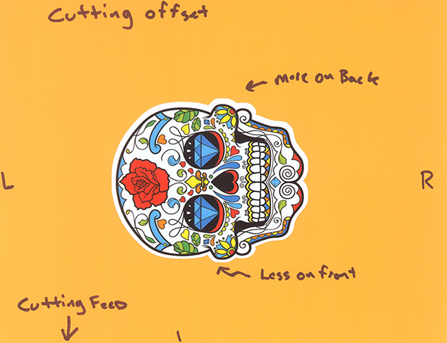

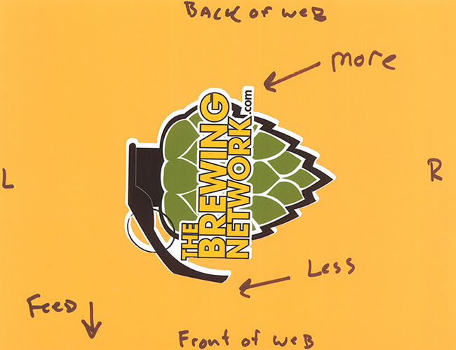

So I have been battling trying to figure how to keep this from happening. Please look over my two photos that I have attached. These were both from a very short runs and they both were off in the X direction. The Y direction looks dead on and is not a concern. Here is my equipment stats Onyx 10.1 rip, HP LP25500 Latex printer, FC8000-60 cutter ( Settings for this job are Condition: 3 Slot three .75+/- Mark size. I have tried doing Mark Scans as well Sensor readings and adjustments, but having been successful of ridding of this problem. Any pointers? I have also double check artwork and die line to make sure they were not skewed prior to printing.

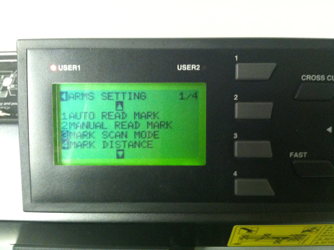

So when I'm on the FC8000 onboard computer with in the 2 ARMS Setting profile I've notice and never question why I can't activate [1] Auto Read Marks and [2] Manual Read Marks. Both numbers are not highlighted like the the other numbers 3 and 4 therefore I can not use them. Why is that? Do I have some settings off?

Hmmm Changing back to Default setting didn't change a thing. I also changed the command around from GP-GL to HP-GL and back again. No change. The picture attached is what I see on my control panel. #1 and 2 is not activated. Looking thru the FC8000 Manual Page 5-36 I would like to try MANUAL READ MARKs, but I can't with my current situation. How do I fix this?
Since I just switched back to ''Default Settings" should I load on the FcC8000 Firmware back on?

Not familiar with Onyx, but using FlexiPro, we select the registration marks from the software, not the plotter. If you have a level of Onyx that supports contour-cutting, try selecting the registration marks in the RIP. Graphtec Type 1 Automatic or Type 2 automatic.
