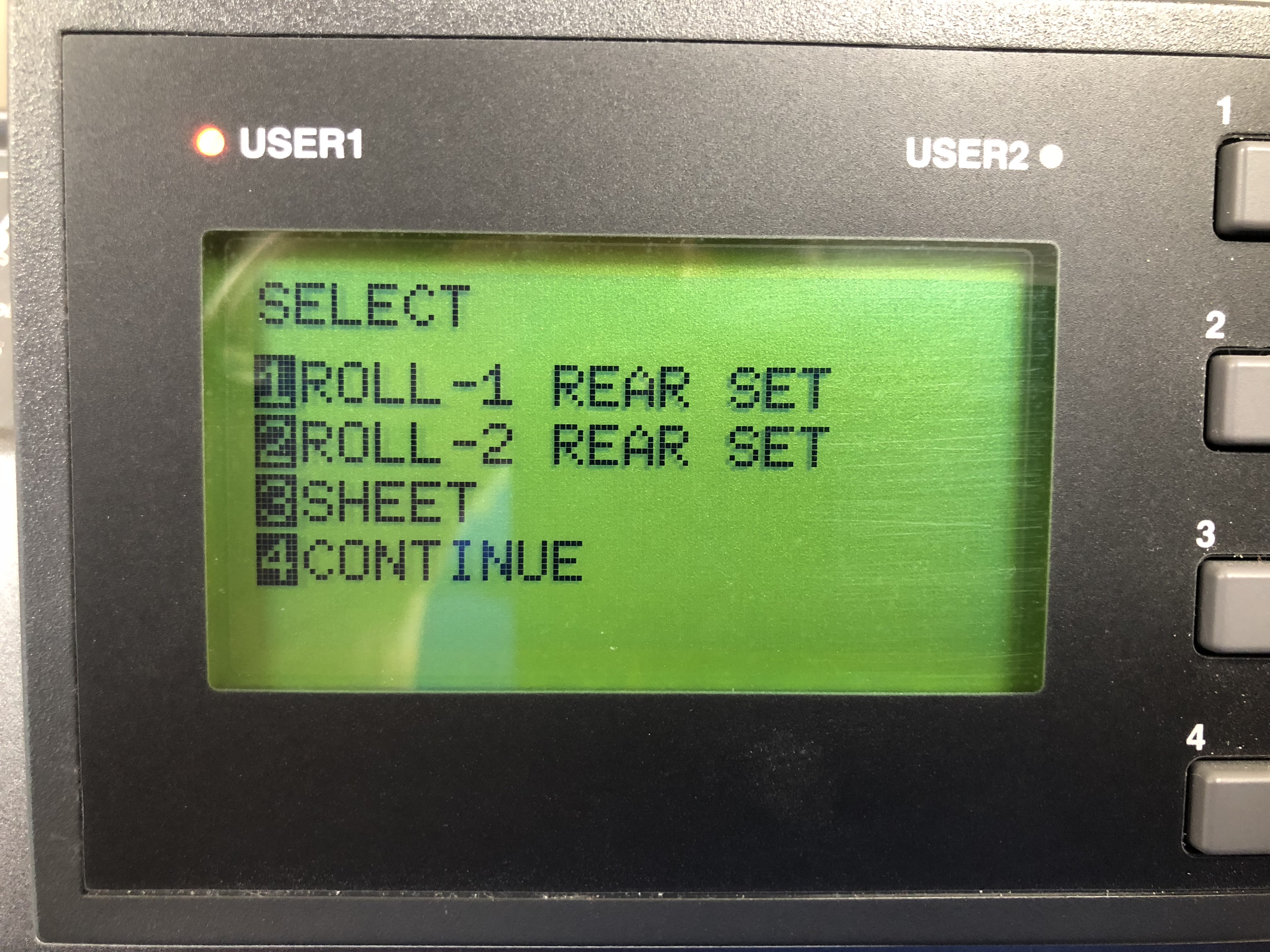

I feel like this used to say something else for #1. Does this look right? #1 was normally what I hit, but I thought 1 and 2 used to be different.
