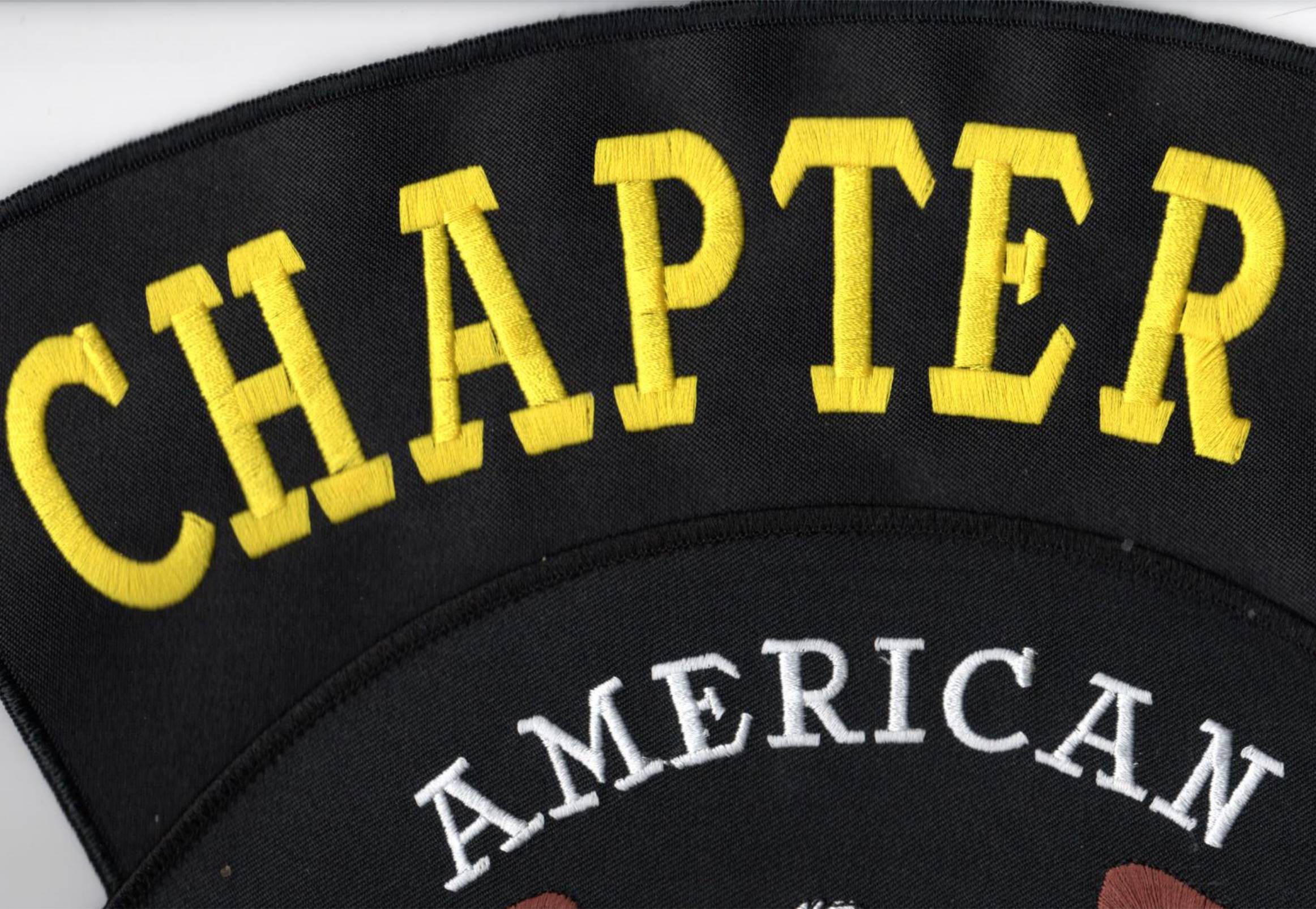

I am guessing this is a Wilcom embroidery font. Any idea on the equivalent font for both the Chapter and American?
It's not in any of the standard fonts that I have for Wilcom. It may be a 3rd party created ESA font for Wilcom software (unless it could be a retired ESA font). Or it could be for any of the dedicated lettering/monogramming software out there that have their own selections or even a Pulse font.
binki
I think I am going to use Bookman as a donor font and just make the adjustments. Thanks for the help.

If you dont need to have any other copy then that original work, could use the embroidery software to trace over.
I mention using embroidery software versus something like the bezier pen tool in Ai or DRAW, because they tend to be (atleast with Wilcom) far quicker with tracing then vector programs l. Sounds strange, but it makes since since in digitizing copying a source file is what 95% of the jobs are. Also depending on how much tweaking using a close enough font may need as well.
Just may be easier to do it that way.
binki
When we first got into embroidery we were supplied Wings Experience from Mesa. We have the pro version now but not the latest version. I would have preferred Wilcom but now the price is just too much since I have spent over 10 years in this one.
That is what I am doing, tracing the letters I have and using bookman bold and adjusting for the letters I don't have in the sample patch I recieved.
