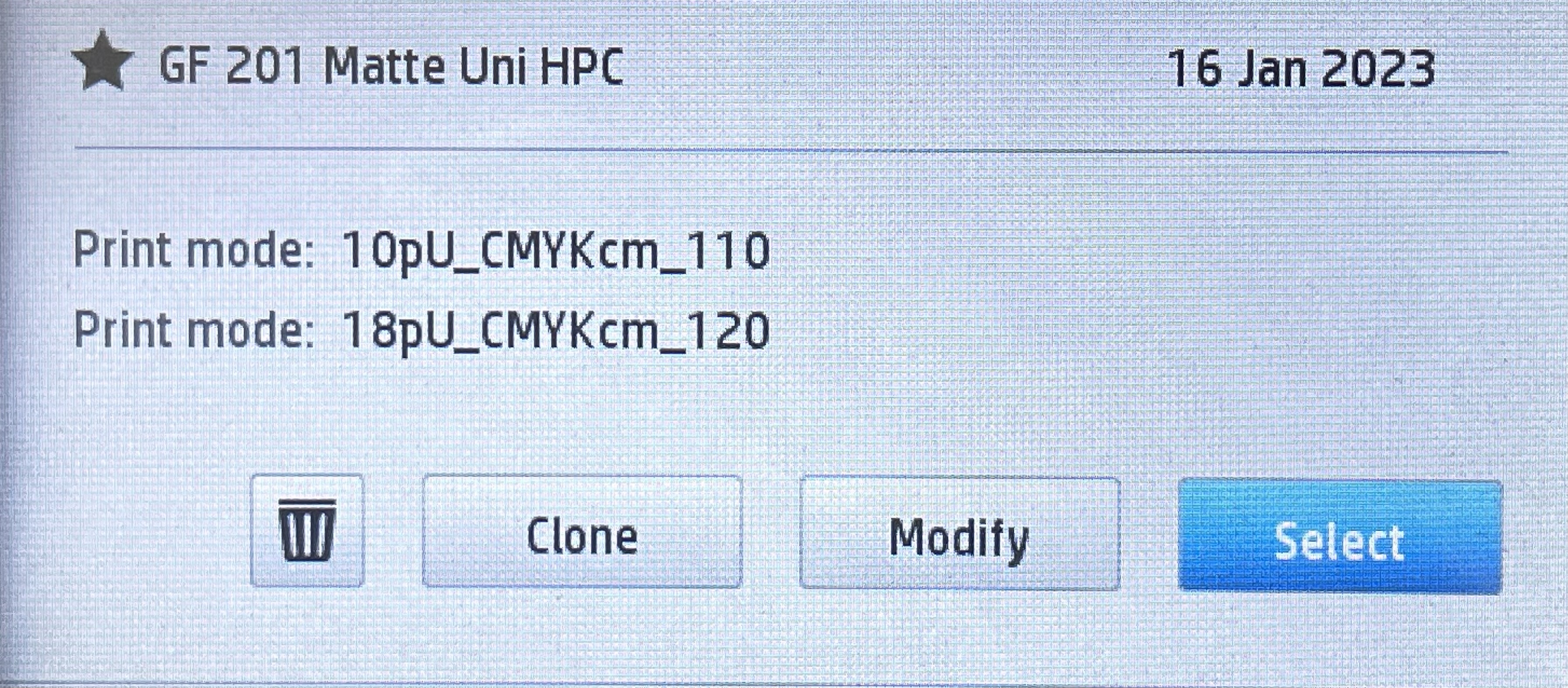

dypinc
Figured out how to add the U in print modes. You should be able to do it from your RIP, at least I can with Caldera.
