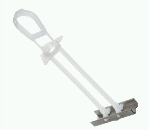

bring an assortment of anchors. For drywall my favorite are the ones with cable ties that pull the 'backer'inside the wall...tight to the backside of the drywall. If I have failed to describe the style let me know & I will dig up a link. This is the only way I would feel confident installing a sign of this size & weight without installing into studs.

I think this is what Just another sign guy is talking about.

Those are very cool. Great idea. So does home depot or lowes have them? I have a project waiting for that. looks like they need a big hole like toggle bolts.

Thanks for all the help guys they are up and sturdy. I went to home depot and got some anchors with toggle bolts!
