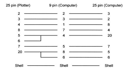

2) FC 2100-60a needs a Graphtec serial cable. A stock 9pin serial to 25 pin serial cable will not work. You can buy the cable from Graphtec or have one made. Attached is the wiring diagram.
