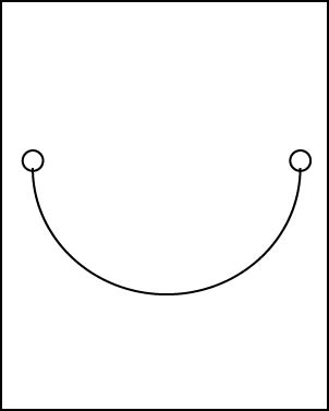

this is what we use, see lay out attached
we also make steel rule dies so we just made one in house, works great

do we have to say to make sure you always have the half circle going down
so the wind slit doesn't fold over while the banner is up...haha
