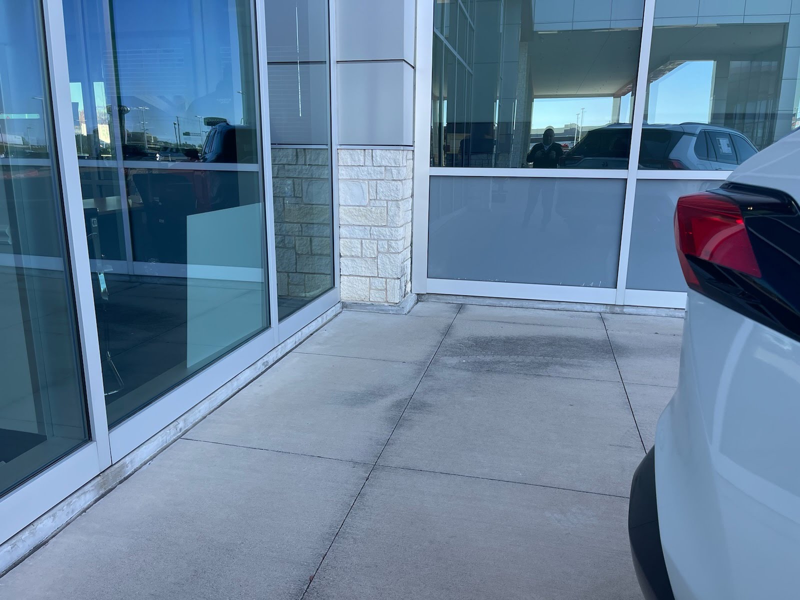

Client has grey vinyl on the INSIDE of the windows they want to replicate. I'm thinking the only option is cut vinyl... but is there a product that I could use that is air release that gives that grey look or do I have to tough it out and use regular cut vinyl?

They are trying to hide the desks and junk. It's not frosted vinyl... a solid color. And will be done from the inside to match the others.
I might try the calendared vinyl with a wet install and see if I can make that work. If not, I priced it well enough to cover cast w/ air release if I have to go that route. I know last time I did bottom windows full coverage cut vinyl it wasn't air release and a royal PITA being crouched down on the ground trying to install without bubbles... but that was dry install so maybe the wet will help. They are wanting 39 windows done so whatever I come up with needs to be tolerable.

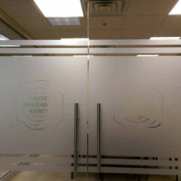

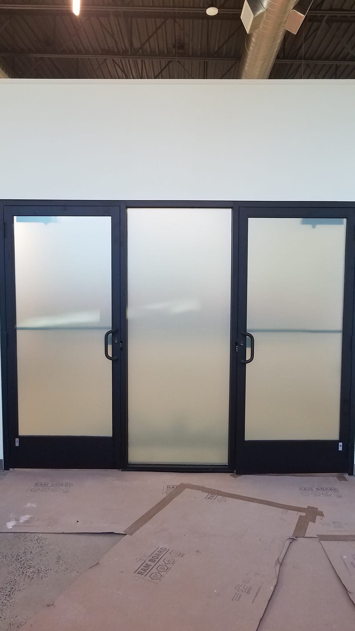

i use mactac B-Free frost/etch material it's air release and dry install. use it all the time with no issues. if you get small wrinkles you can usually get them out with a little heat from the torch

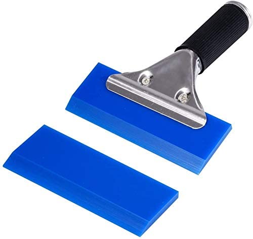

I use a window tint squeegee. Just need to wet the surface to make it glide. I use the same tool for frosted vinyl without premask. It push the water behind the film alot better than any other squeegee.
