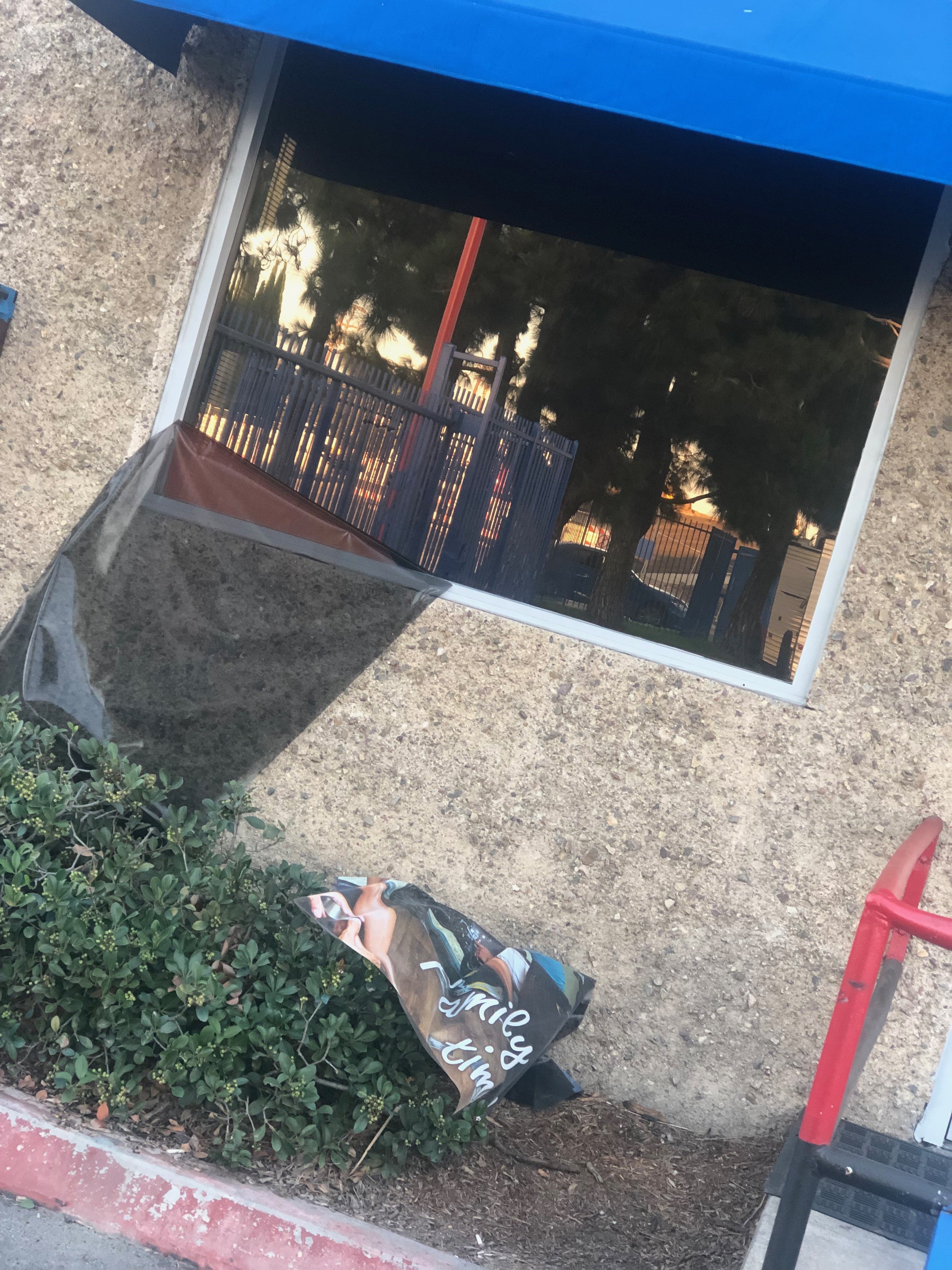

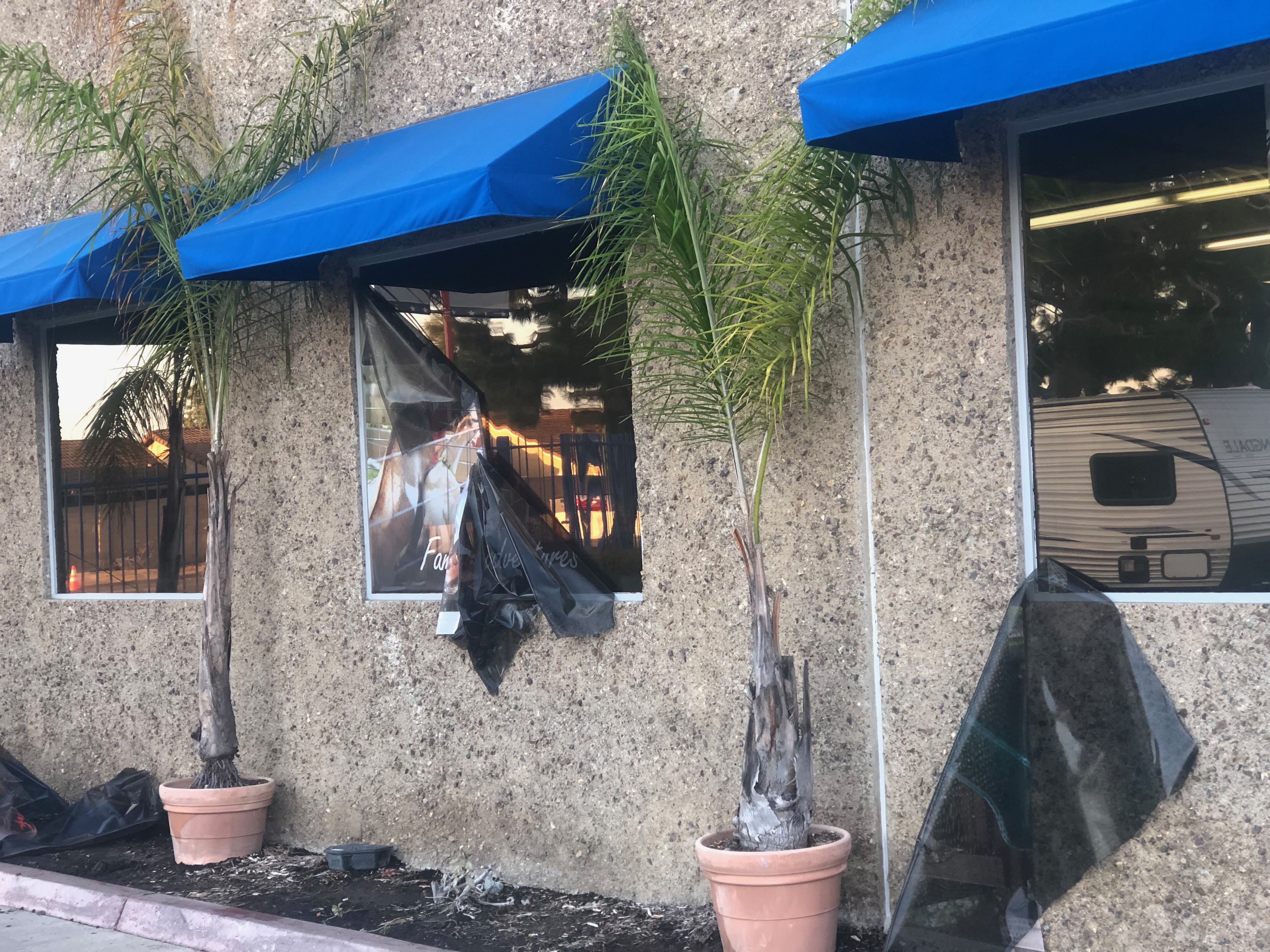

We are having trouble with a project that requires window perf. We have installed this film 3 times and it continues to fall off within hours. We originally thought that the glass was cleaned with a simple green or a silicon based product so we cleaned/scrubbed the windows with Alcohol and a scrubbing sponge. We tested adhesion with a few 12x12 squares of perf and it seems to adhere really well. We then installed new perf on the glass and it fell off within an hour. We have no idea why this is happening and we need to find a resolution. The perf we used is a clear focus with no lamination.
Does anyone have a solution for this issue, have anyone had this happen? Please let me know your thoughts.

wow, that's crazy. It literally just fell off, i thought you meant it was like peeling at the edges. It 100% has some type of coasting that doesn't allow the adhesive to activate.
