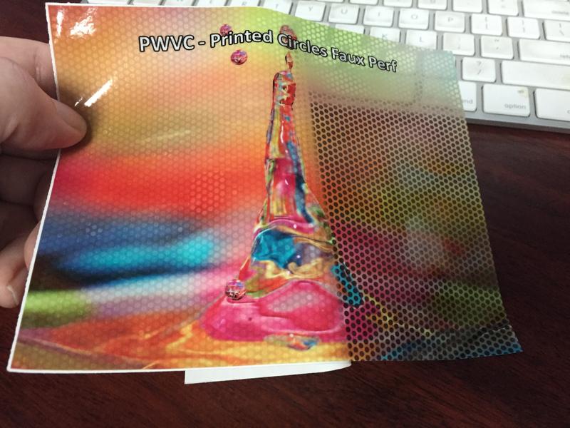

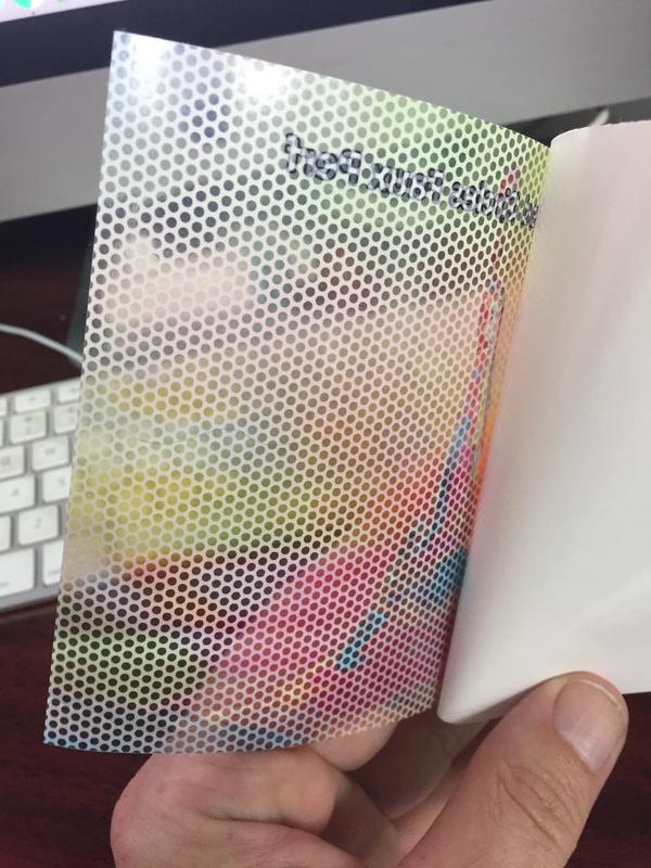

Also, GANS INK has a product called PWVC-Printed Circles Faux Perf. It's essentially clear calendared(?) adhesive vinyl with a perf pattern printed on it from the manufacturer. This gives you a solid surface to print on, but it's not optically clear so when you apply it to glass you won't be able to see through it clearly. See the attached photos of this product below. BigFishDM is a merchant member here that is the Wide Format materials guy with GANS. He can help you with this product if you're interested.http://www.signs101.com/forums/member.php?17617-BigfishDM
