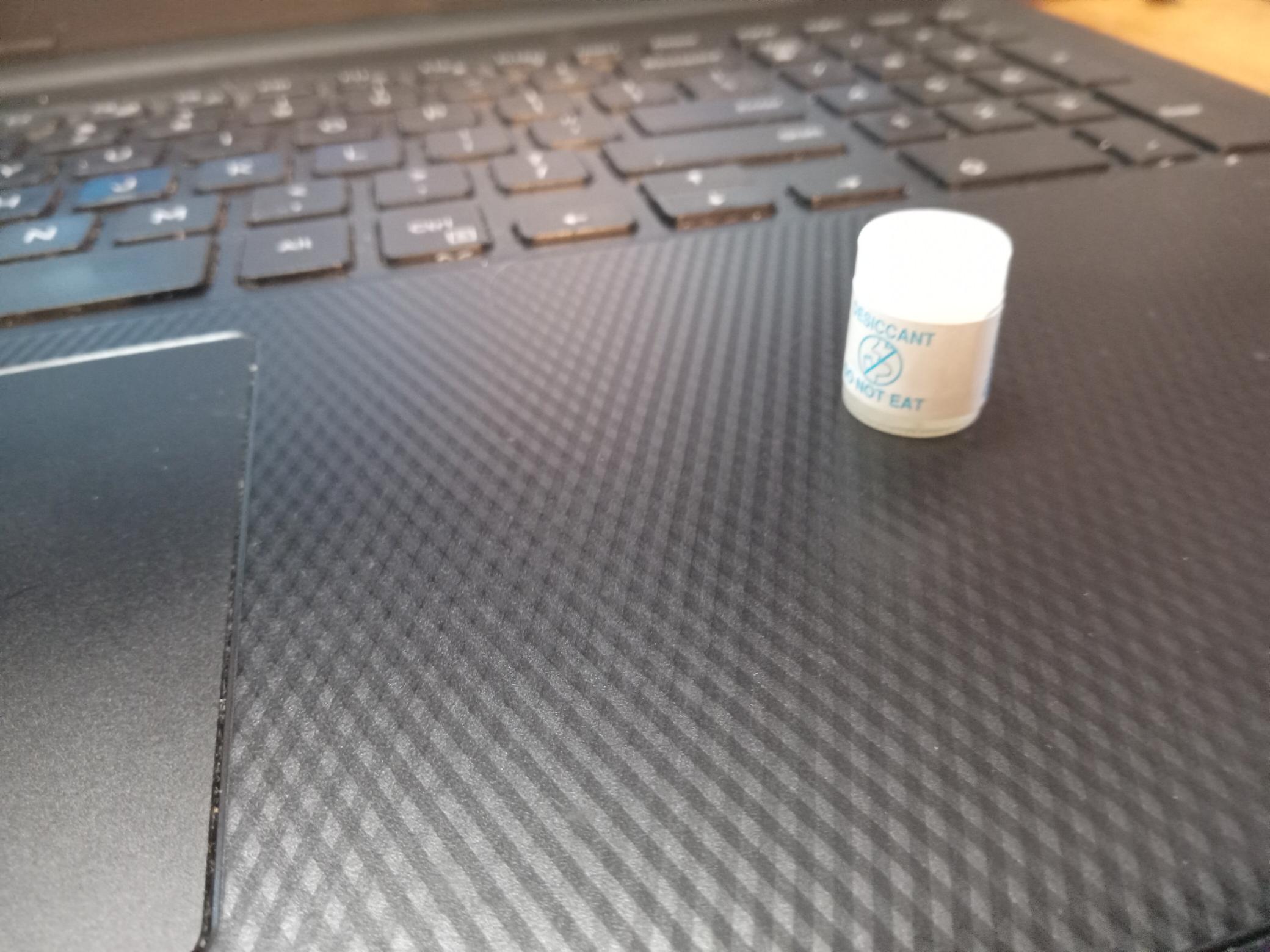

i am the worst as far as storing my materials improperly.
that being said, would it help to store the perf in a bag with something hydroscopic (rice, or some of those little capsules that come in my prilosec?
if we can control how much moisture the paper absorbs, you could minimize the situation
