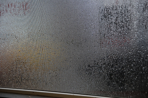

We do a few a week and laminate all vehicles unless they're specifically for a short-term promotion. Our customers typically use them for ~3 years before upgrading vehicles, and using latex inks and Arlon 3200 laminate on Clear Focus AutoVue we don't have any longevity issues. Beats driving around with this view when it's raining, foggy or dusty.

We have been using Orajet 3676 accompanied with the 297F laminate, which has worked perfectly for tons of customers. Result is flawless and the laminate protects the print + clears away the water better w/o the result showed in the previous post.
