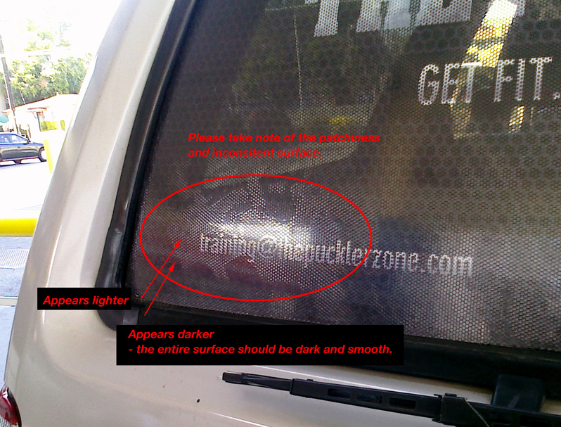

I have a customer who is reporting an odd problem with her 50/50 window perf film. I have attached a photo of what they are seeing. Essentially, it is an inconsistent and irregular pattern in what should be a solid color. When they printed and laminated, everything looked fine. After 1-2 weeks on the vehicle, the problems were highly visible. Particulars are:
Printer = Roland VersaCAMM 540 VPi
Inkset = Roland Eco Sol MAX
Print Media = Tru View (McLogan house brand
Laminate = Oracal 290
Thanks in advance for any insight into this.

Could be wrong, but it looks like either the laminate is coming off the perf, or the perf is coming off the window. Have they/you used this combination of materials before? I've heard mixing brands of material & laminate can cause problems.

also looks like could be moisture in there (not sure how)

i have done perf windows with over laminate that looked great just after being done. but then within a week or so larger bubbles looking like that will form with moisture will form. the moisture will go away after a while but it just need sunlight and some time.
If it is moisture can you move it around with your fingers?
also never pop over laminate on perforated vinyl. it just lets dirt in and you'll have a black dot

To me it looks like areas where the laminate has been forced deeper into the holes and is sticking to the glass. I've seen similar where an automatic car wash pressure nozzle have near the same appearance.

yeah, looks like the material has either lifted from the window making a bubble or the lam has lifted from the window perf......
My 2cents exactly. + are you certain it was 290f? Not that your problem here has anything to do with it being optically clear or not, just curious. Personally window perf is not my favorite thing to work with. If customer wanst it we use it, of course... but we are diligent about matching lam. to media and using premium, fresh stock.

That looks just as others have posted, either too much preasure on that section or possibly too much heat if heat was used. I personally hate to laminate window perf any more. It causes way more greif than needed. I just give the customer a good price on a non-laminated perf and tell them that the life expectancy is shorter. It has almost eliminated all problems with the perf and the installation time is almost non existent.

I had this problem on my first perf job. I used the Fellers Solvex with Lamex and thought it was the material. Surely enough it's the lam pushing through the holes creating that look.
I re did the job and took installation a different way and no issues.
