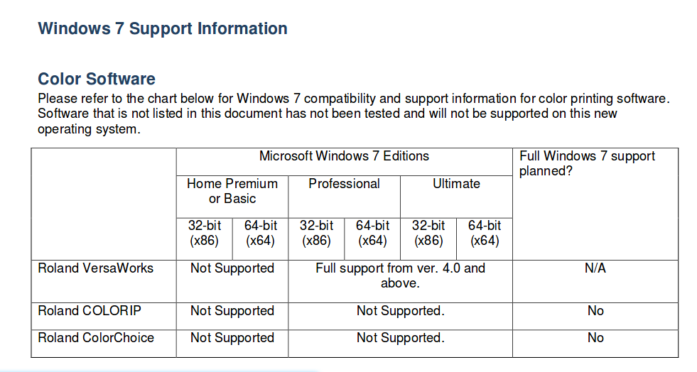

Based on this, they only support Pro and Ultimate with regard to 64 bit versions. I don't know if you have Home or not as that wasn't mentioned.

What surprised me is that Home Premium (32 or 64 bit) isn't supported, unless they need something like Work Groups or something that isn't available in Home Premium, unless I was looking at a old spec sheet (it did only mention ver. 4 after all).

No restrictions to Home Premium like with Ver. 4 (either 32 bit or 64 bit)?
I tried to see if there was a chart like that for ver. 5, but nothing come up. I see that version 4 is good for 32 bit and 64 bit, but only for Pro and Ultimate versions. Not Home Premium either 32 bit or 64 bit. It may still run, but if it's not supported, it may cause some hinky actions.
I don't know, I'm just trying to figure things out. I've never seen where Home Premium wasn't supported, but yet Pro and Ultimate was. Now 32 bit versus 64 bit and what is or isn't supported, that I could understand. If it's 64 bit can't run it on 32 bit etc. This is the first time that I saw support wasn't forthcoming on something like Home Premium versus Pro or Ult.
