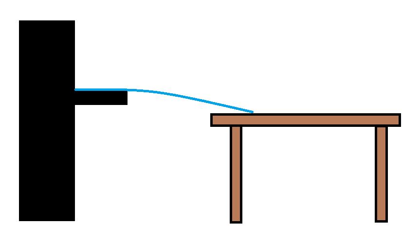

Unless you're going to have the table bumped directly against the laminator, I wouldn't make it the exact same height. There's going to be some flex in material, even if you use a sled, which will cause the material to hit the edge of the table instead of landing on the surface.
I'd have the table slightly lower than the laminator. Here's a quick, dumb drawing to explain what I'm talking about, in case it doesn't make sense.

2B
our work tables are 43.5" h and on casters so they are easy to move.
for our laminator we use the plastic folding tables, they are slightly less than the outfeed height and fold up out of the way when not in use, plus they have a smooth surface so no snags and easy to slide over.
the drawing by Derby is exactly why we use the plastic tables
