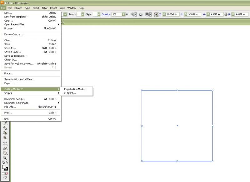

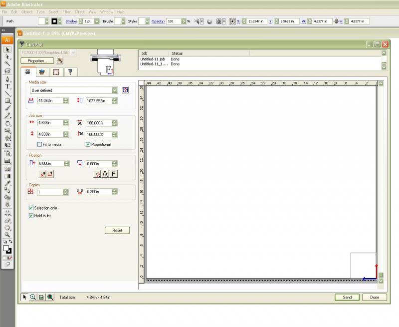

we have a graphtec fc7000 and design in illustrator while printing from a hp 8000.
in order to get around using omega to do the cut work on our plotter we had a plug-in installed on illustrator, that will output to the graphtec. the software is called cutting master 2 and the version is 1.60. to me it looks like what flexi uses to output cut paths to a plotter from what i can remember.
the cutting master will allow you to put registration marks around your print and die-cut your image, and as well you can load regular ol' vinyl into your plotter and cut lettering out too. below i have some screen shots of what the cutting master looks like and how it shows up in illustrator.
i'm not sure if this really answers your problem, but it sounded similar to the issue we use to have.
