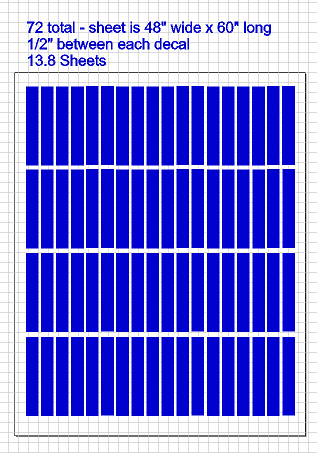

We are low low volume Summa users, until a handful of decal jobs came through our shop. We have 1000 cut lettering decals, 13"w x 2"h, cutting out of Avery tangerine vinyl.
We can run through GoSign for the contour cutting, and even to final trim size, but how to best get them trimmed down to final size and apply transfer tape? Surely we don't want to apply transfer tape to 1000 of these decals individually. What's the best workflow to trim these and apply transfer tape?

You'd get a lot more mileage out of your material running them 2" across the 48" side, at 13" your losing 7"!

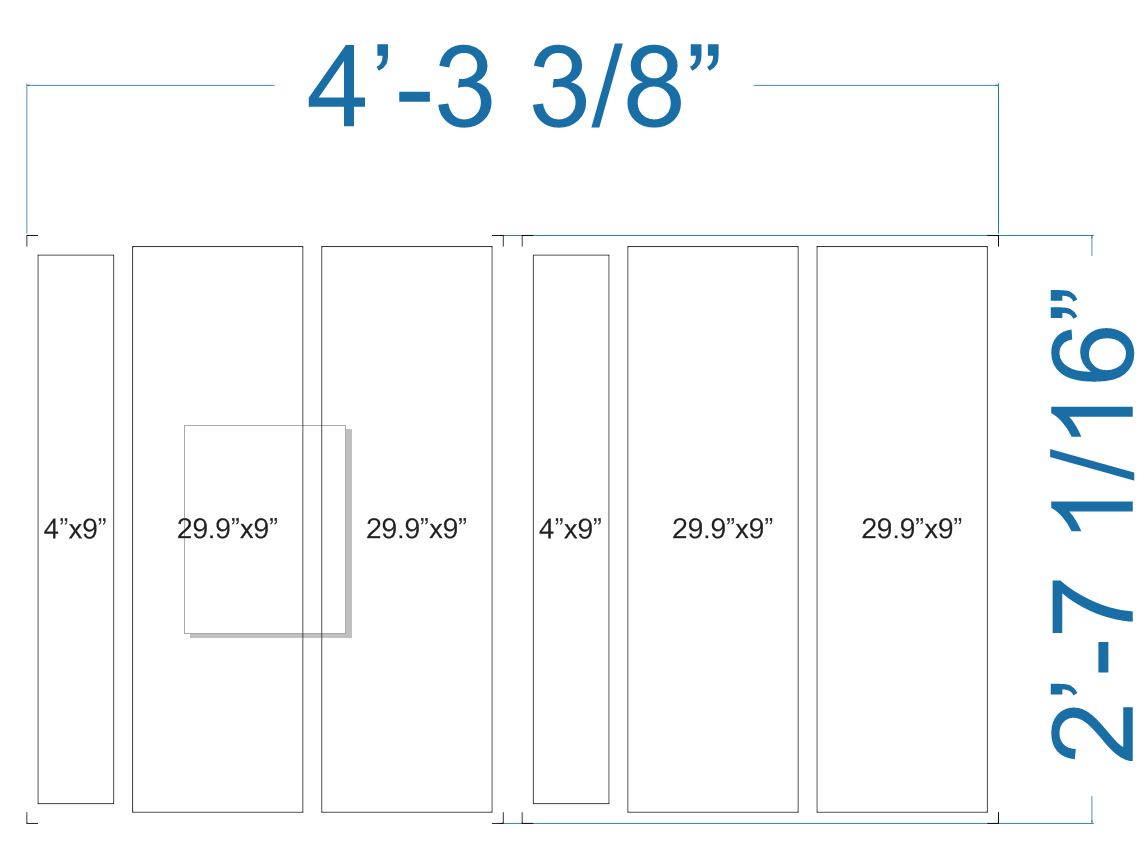

Just another thought, often times it's simpler to eat the cost of a print material vs running two different processes. Something like vehicle kits could easily be batched into 2 doors and 1 tailgate each, within a 24"x29.9" area, run two sets at a time side by side, you'd have enough room for registration marks if you're using a 54" roll. Add the colex marks in an unprinted region, then print, laminate, plot, weed, mask, colex, profit!
