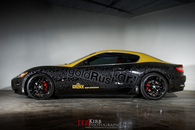

Yeah it would be cheaper. But it would also look cheap to... The client is a hi-end turbo performace shop with a great logo and branding, so I don't want to half-ass it. Tryin to use my whole ass here...
Wrong.... This is a flat black with metallic silver cut vinyl overlaying... sexy as hell.
EGI
That is sexy! But, what I'm trying to do is completely different then what you posted. Those are bascically just vector lines, which could be cut with a plotter. Which would work great like in the attached image. The extra elelments I'd be adding would be bitmap style with gradients and several colors. If I wrapped the car in black matte, and added the logos and such printed seperately it would look cheap. And thats not the kind of work I'm putting my name on. I want to be able to print the logos along with the black field so that it's all one layer.
