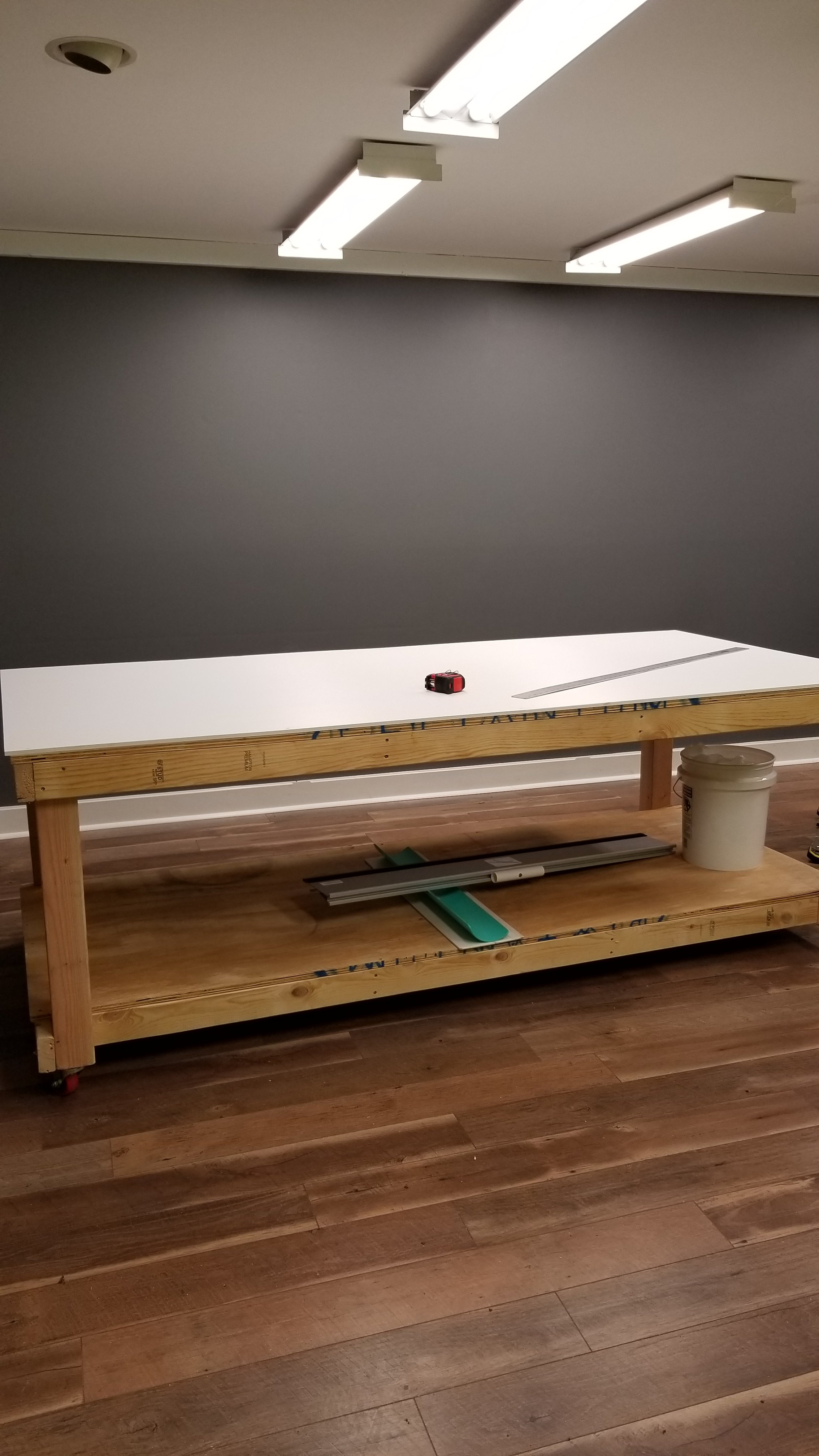

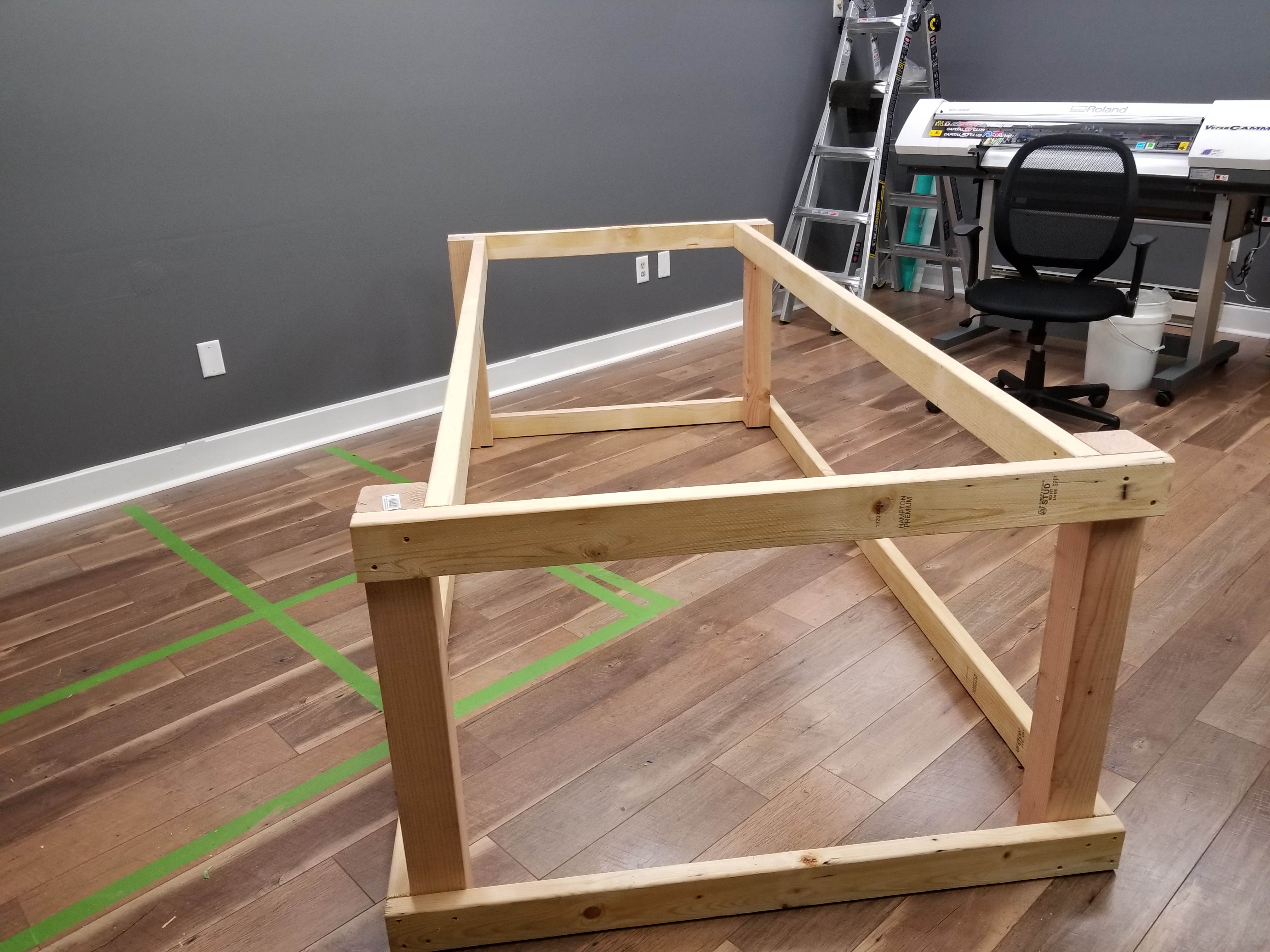

I was wondering myself but didn't want to spend the crazy money so for $200 me and my brother in law built this. 3/4 ply with 3/8 high impact pvc. Not bowing and glides around like a feather
