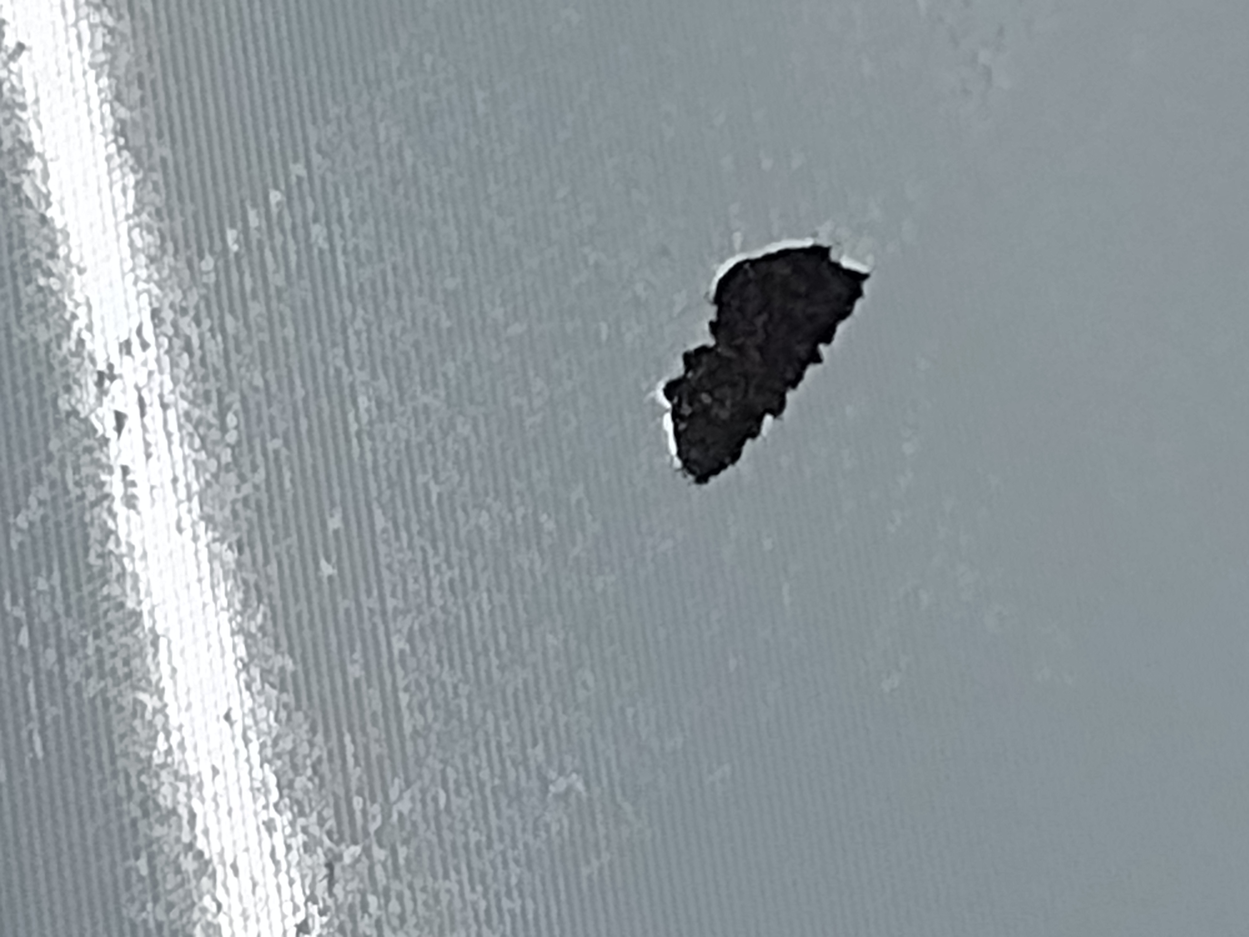

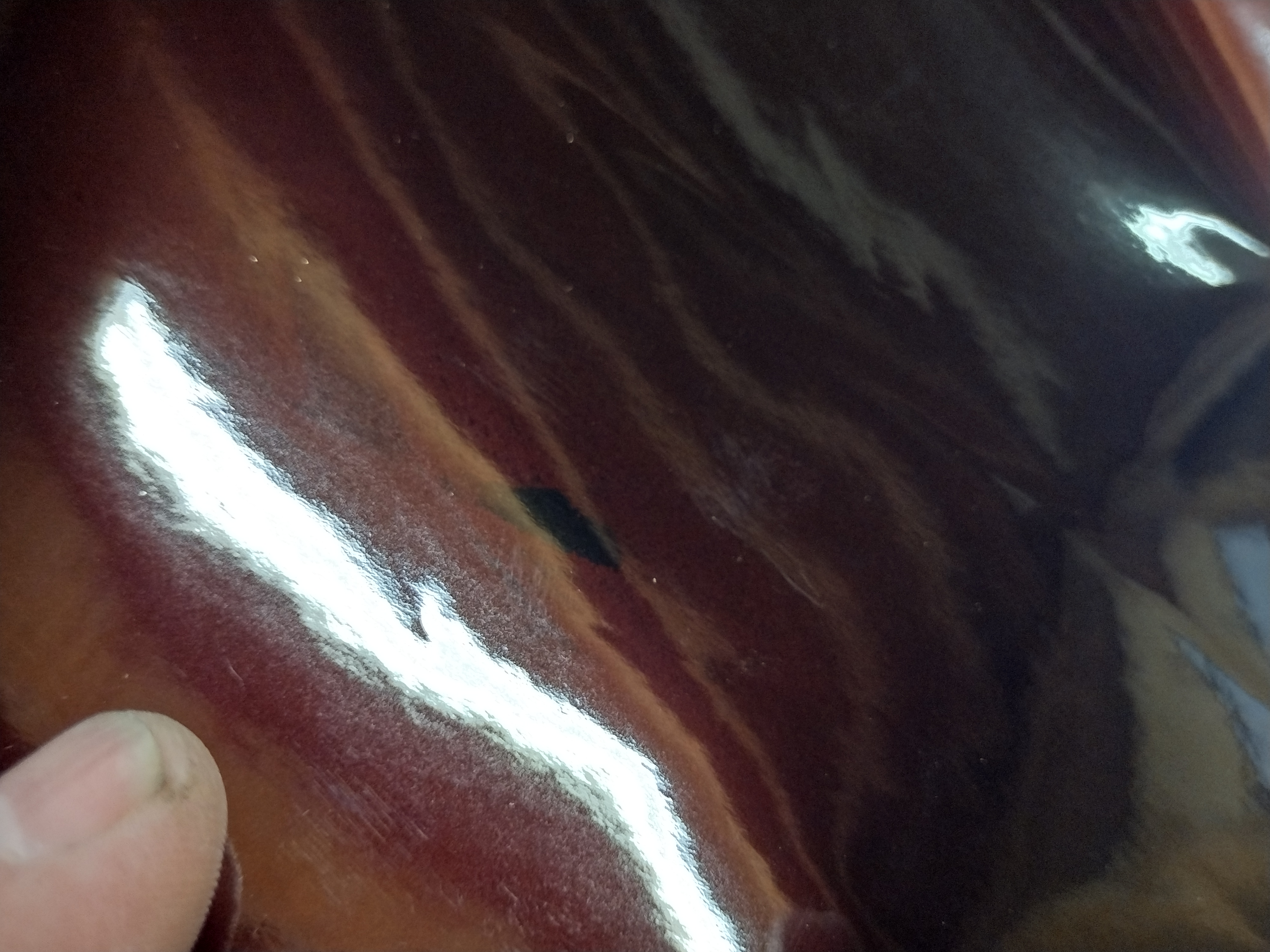

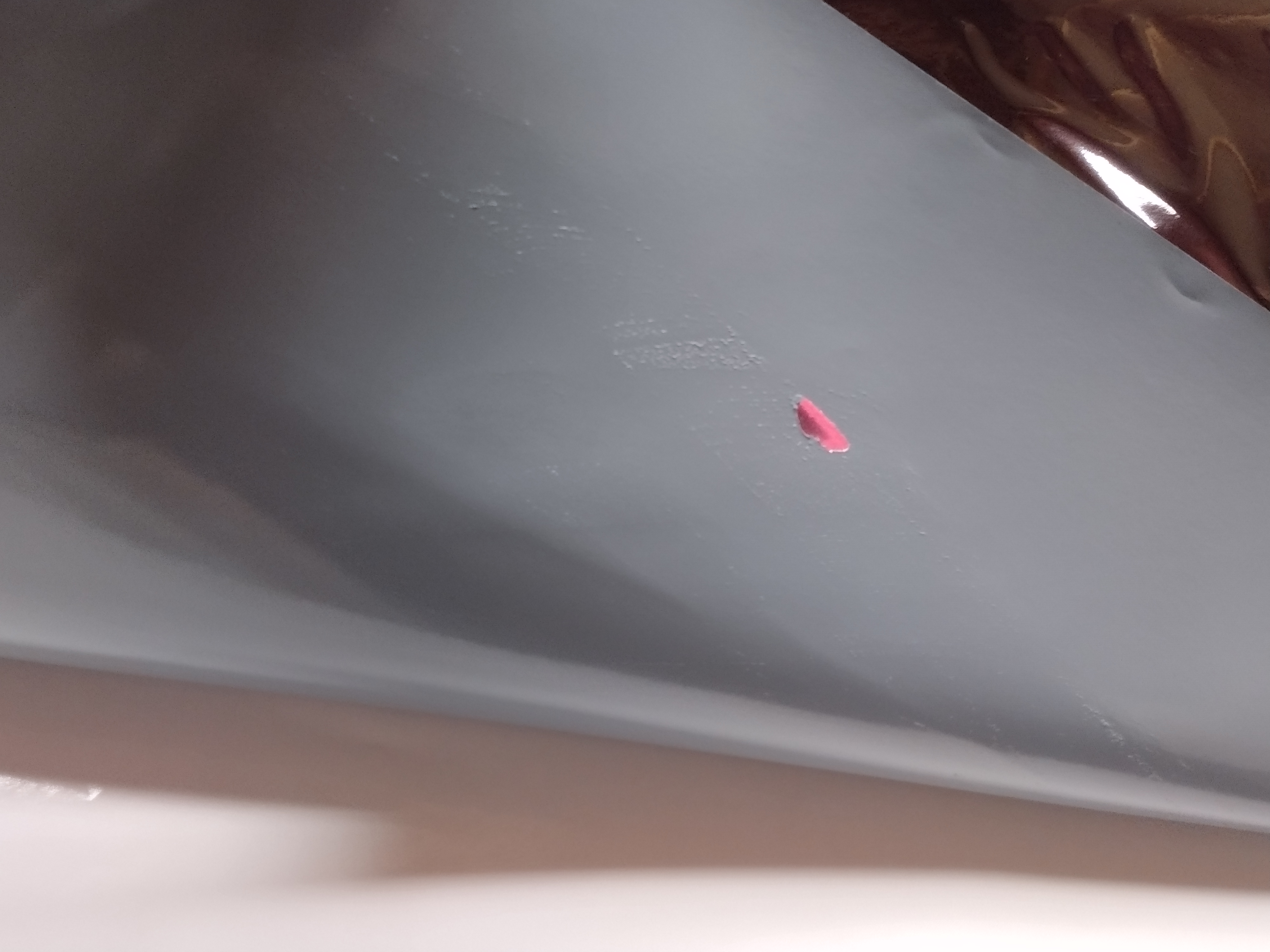

Has anyone had an issue with wrap vinyl adhesive pulling off when installing? The vinyl I am using is Vvivid Demon Black, gloss, it’s a new roll. I’m not sure if it’s a bad batch, a climate issue, or user-error. But I have never had this happen before. The car was thoroughly washed, clay-bared, rinsed, and prepped with Iso-alcohol just before installation.
Here is a bit more on the issue. When the adhesive is exposed to the air it tends to behave like it should, I can lift the vinyl off the car’s surface and reposition it around as usual without the adhesive coming off. It’s as if the adhesive needs to “” breathe” a bit before is acts like it should – a low tack adhesive when using light pressure.
Sidenote: I have wrapped in colder climates, using the same brand, a solid gloss black in a 50-degree climate and the adhesive did not come off. The solid gloss colors seem to be thicker than the specialty colors, so I’m wondering if I need to install them in a climate over 80 degrees.
If the cause can be narrowed down, I’d really appreciate it! Thanks!

vivid is a calendared, very cheaply made vinyl that has a high failure rate. It's not intended for wrapping cars.
Thanks! I've used their solid color wraps before and had no issues. It's just now that I'm discovering some problems with their "premium" line of metallics. They are thin, but so are most chrome vinyl wraps. However, I will be switching to Avery and 3M.
The good thing is that Vvivid offers a warranty on their products, and I should qualify for a full refund/replacement. The wrap industry is a megalith, it generated over 7 Billion in revenue in 2023 and still growing, and I'm sure these companies are trying hard to improve their products as long as they hear from their customers.
