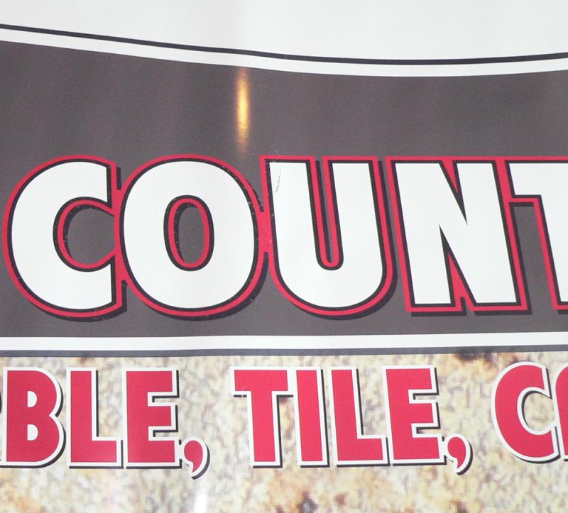

I just printed a wrap for the left side of an F-150 and my material hit the ground, folded wet ink over wet ink (yikes...need a take-up reel), and left some unwanted ink in one of the white letters (see attached pic). Is there any way to take a swab and get the ink off the white letter?

Depends on how hot your solvent inks are.
Mild eco-solvent.
If it's just the white material a little iso alcohol may dissolve it and you can wipe it out.
raider
I've touched up the same boo boos with a sharpee's but we were laminating of the print so durability wasn't a problem.
Signs4Realtors
Thank You! I used my cleaning solution and a swab and it removed the ink from the white lettering perfect. No need to re-print.:U Rock:
