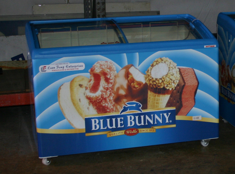

Don't know if these are the same as what you will be dealing with.
These are in store units and not portable.
We wrapped 60 of them, brand new still on the pallets.
Used intermediate vinyl and 210 Oracal lam.
We sealed all the edges of the panels with sealer pens to minimize the shrinkage & edge lifting.
No issues or comebacks.
wayne k
guam usa
