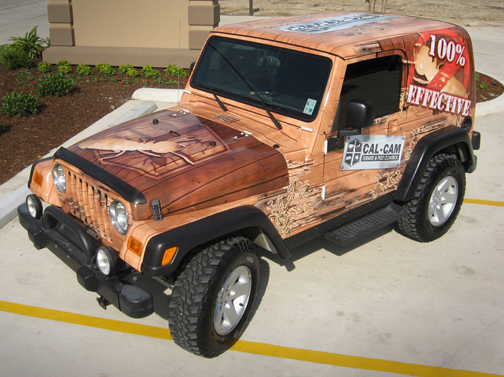

Here is a pic of the Jeep

Here's a Jeep with a full wrap, top & all.
:thumb:
I appreciate the reply, but can you offer any insight as to how you did it? What material did you use? The jeep in question is a hard top, but it has a texture to it, not exactly smooth.
