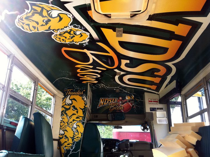

formanek
Ceilings suck. I had to do this one alone and it is not fun. Make sure you charge A LOT!
