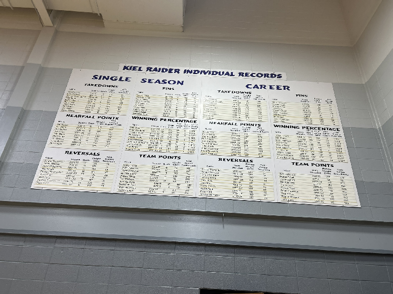

What is the best method for creating signs that you can add names to each year? They currently have the slide-in plastic things for some and for others just signs that I cut vinyl names for and we stick them up. I did not make any of these originally and as you can see lots of different fonts have been used over the years.
Thoughts???

I think both of these are good ideas. Or, for how cheap banners or poster prints are, they could do complete reprints every year. I like the wrestling one, but they could have done pre-set spaces & years on it, so the names don't get out of wack. The other one looks pretty boring, it could be re-designed with more up to date graphics while re-using the same slide-in panels or making all new ones.

We did a big ol' swim records board with steel faces, a grid, and sold magnets for each record. This way, they can replace any given record without us going to site, saving tons of money over the years. These days, you could get ACM that is metal faced and make it flat without too much buckling.
Also to note, this is a project I spent hours trying to apply .25" strips of vinyl to make a grid, and it looked awful. Suck it up, quote the whole thing covered in vinyl, and plot out grids that you can mask. Or, get ready to start your new career in pinstriping!

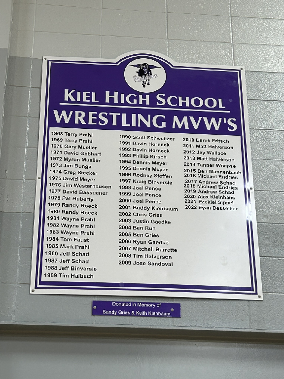

2 things I'm noticing on the MVW's sign:
1. All of the lettering up to 2009 looks to be done by the same company, or that's when the sign was originally produced. Why didn't they put 2010 and 2011 on the middle column though?
2. Joel Pence and Wayne Prahl must've been monsters!
the Prahl family holds 6 spots and two of them multi year so it's in the genes
Clearly.
Also, I guess this was donated on/around 2001, by the Kienbaum family, for the Kienbaum MVW.

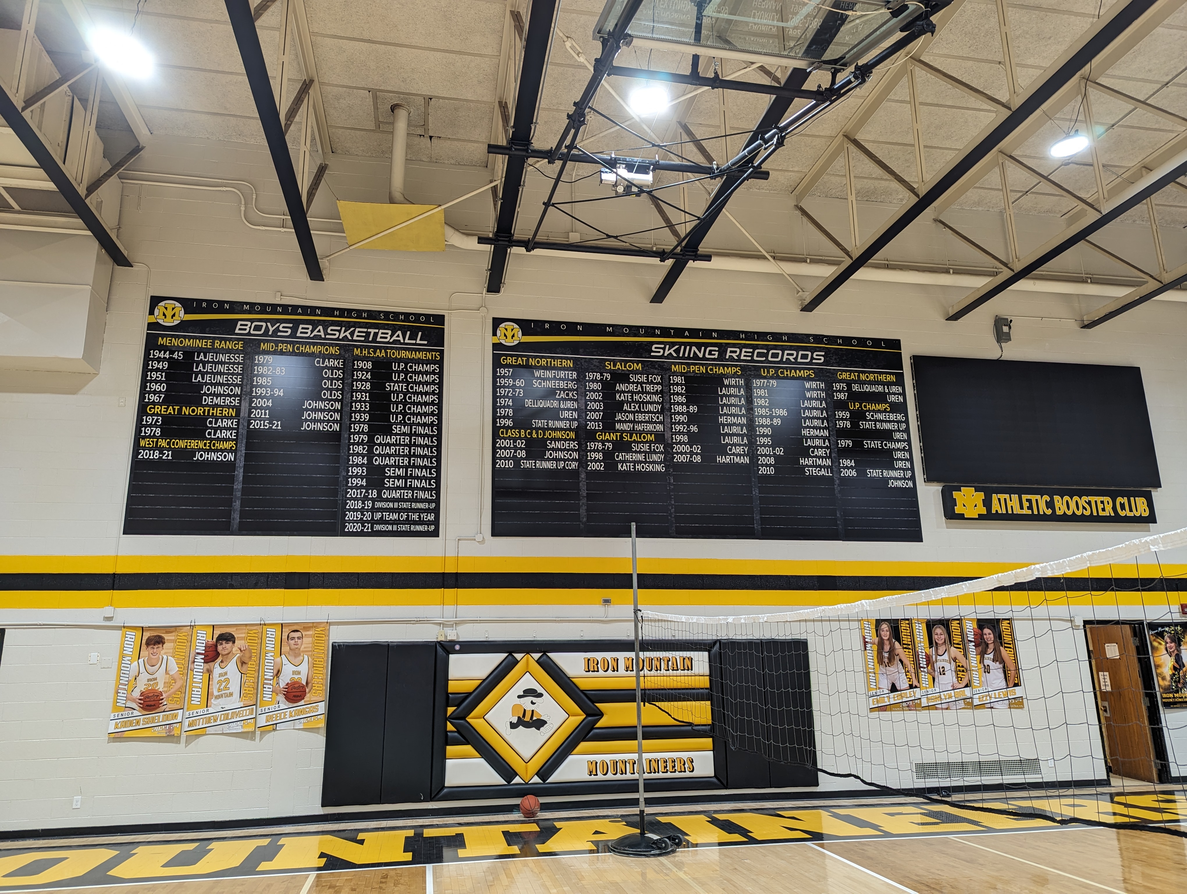

We've been using either Switch It magnetic frames, or adhesive backed magnetic sheeting on ACM or Alumalight to creat changeable roster/record boards. We print the base layer on magnetic receptive material and then the changeable names are applied on top. We use this same system for menu boards. Here is a link to the Switch It website.

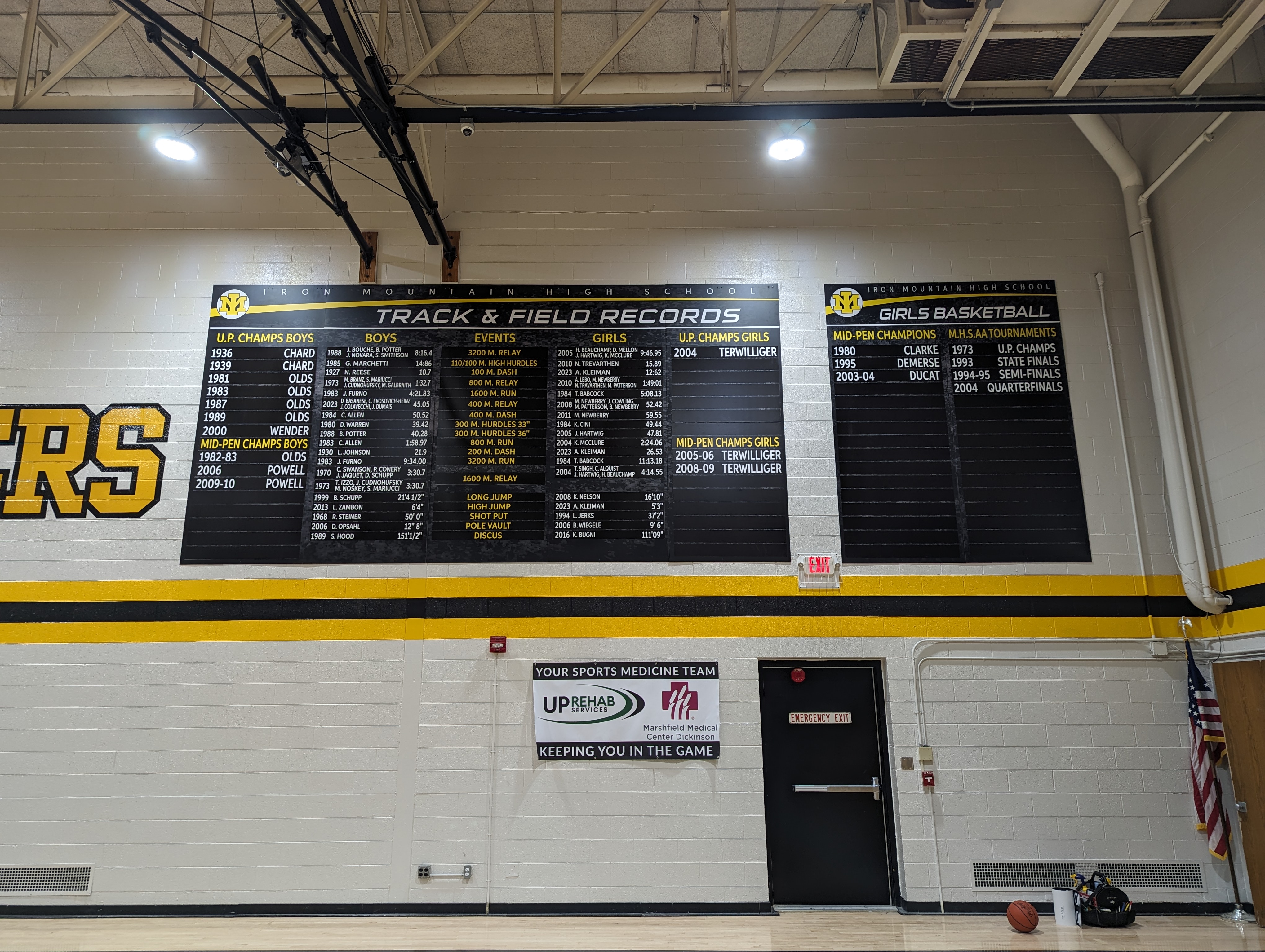

Here are some that we did. We used adhesive backed magnetic material and we'll use printable magnet material to add to these. Just finished them so we'll likely be trying it out next year. I used to add cut vinyl to each name/record with a ladder and it was a PITA!
