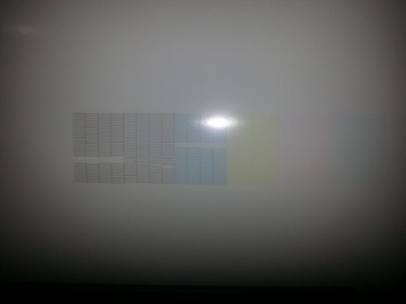

I have a mimaki jv3-160sp used. I have noticed that i am not getting red in my prints and that Black is coming out heavy. When I do a test draw( six color setup) Black is print in the magenta slot. I have checked the printhead for malfunction, printhead is fine. Switched printhead same result. Can anyone help? thanks in advance

the testdraw prints perfect. however instead of printing KMCYLmLc it prints KKCYLmLc.

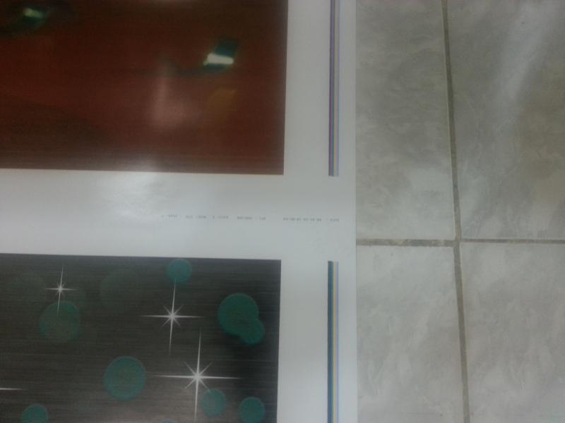

Thanks for your response. I will check the magenta cartridge. At times i notice only black in the capping station and then i would see some magenta.( Could have been after a clean during plotting) I have attached the test draw photo and a clip that shows the color pattern while printing. Notice that there are two black lines then later the magenta line reappears.
thanks to all i will follow up on monday. 20131206_164816.jpg 20131206_195807_1.jpg
