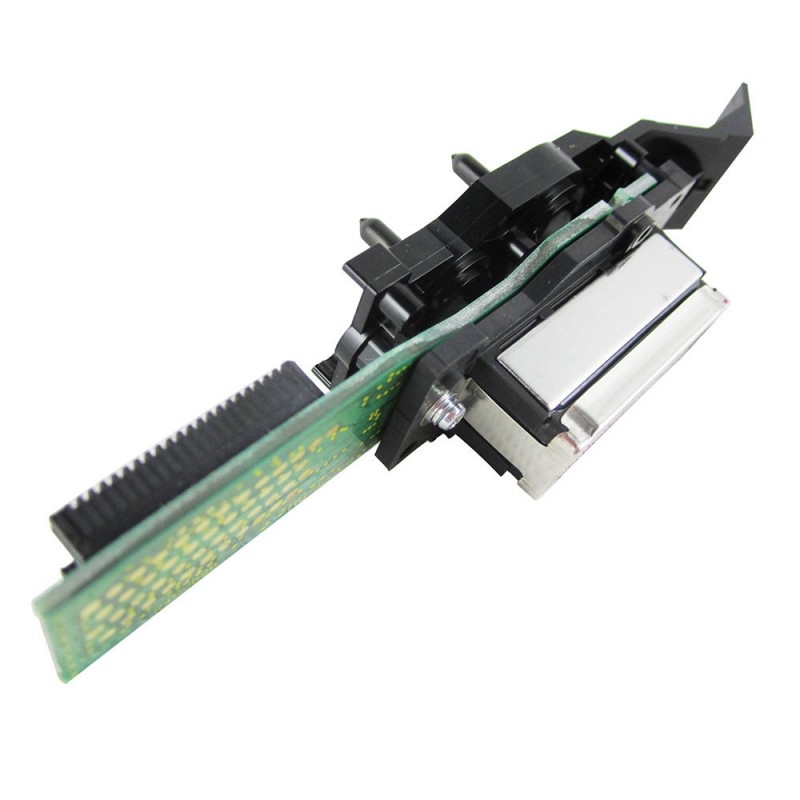

Hi! I think you bought the Water based or Aqueous print head instead eco-solvent/solvent print head instead. If that is the case you can use it in service mode but not user mode...look at pictures white is water based print head and black is eco-solvent print head
  • new-cheap-dx4-eco-solvent-printhead-for-roland-sp540vsp300vvp540vvp300v.jpg
