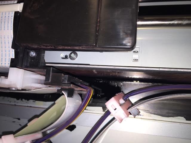

A technician exchanged print head on our Epson SC30600 for about 1 month ago (the second time because of an error in ink by manufacturer). And then this happened today, see pictures. INK cables has jumped out of the slot and broken them, now it has been splattering black ink over everything. What to do? :frustrated:

Is that a bad crimp I'm seeing in all of the lines?
Could it be a case of the Tech not putting everything back
right that caused the issue? If so, they need to make it right.

Looks like it to me.
Looks like someone put the lines back in in the wrong way. Then when the head moved the lines kinked and either cracked or popped off a connection area. My guess would be they put the ink lines back and bent them the wrong direction. Before touching much of the machine I would look at diagrams for how the ink lines are supposed to be run and see if they are incorrectly led in that machine.
AaronSSsignsKC
That is an issue with something your tech did, there is no reason your lines should jump like that allowing them to crimp. I would have them on the phone asap!
clean the splatter ink, install the ink cable correctly.

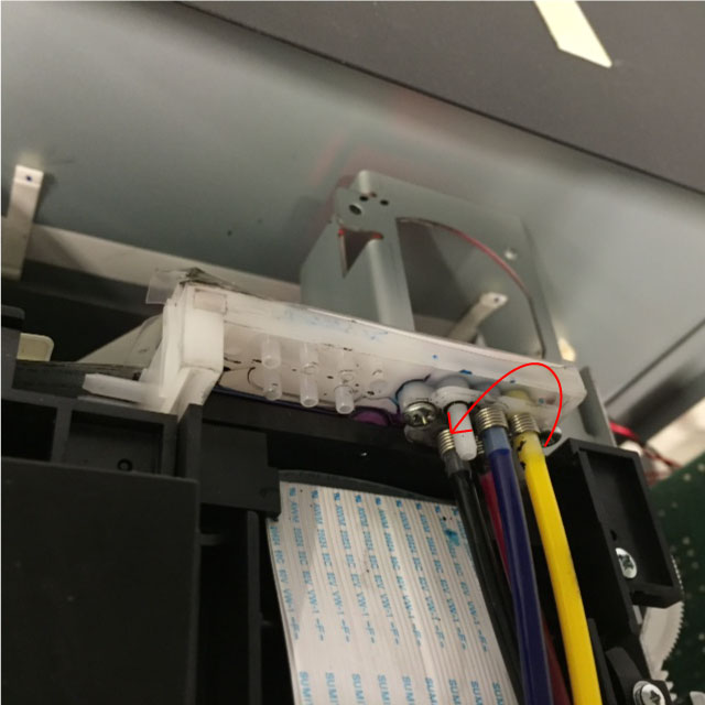

I found out where the leak came from, it was the plug to the tube with black ink on the INK tubes path card, it was cracked.
Since there is several channels on the card, I put the black ink tube in a new channel.
Had no faith that the print head was still working thought, since it has been so long outside its station.
But then, took a test print and all nozzles work and the machine is as before :smile:
So much anxiety for someting that was so easy to fix:rolleyes:

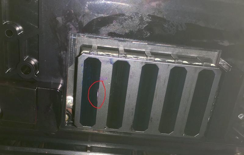

Now our print head has been damaged -_-
We have since day one had problems with the cleaning wiper on the printer,a few times it has jumped out of its place when cleaning.
I think the wiper is responsible for damage the head.
See attached picture: M1 won't print, is this damaged plate the one that prints M1?

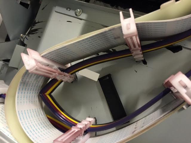

message for mr bluespot
is there supposed to be a clip that clips the 'off white' stiffening 'strips x2' to the carriage
this don' t seem be in your pics, ad I'm missing this part also
do you have a pic
thanks
pic 3 - ribbon to carriage
