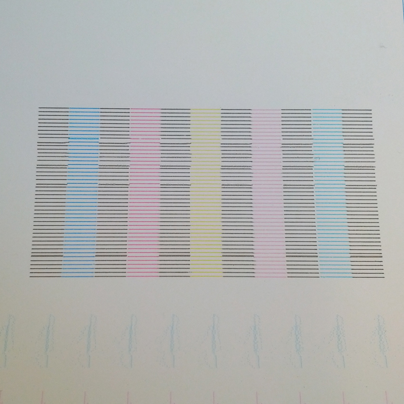

Tried to calibrate my XC-540 and noticed that when it prints the test, H6 prints very blurry. This only occurs when printing DT3 and not DT1 though.
What is DT1 and DT3?

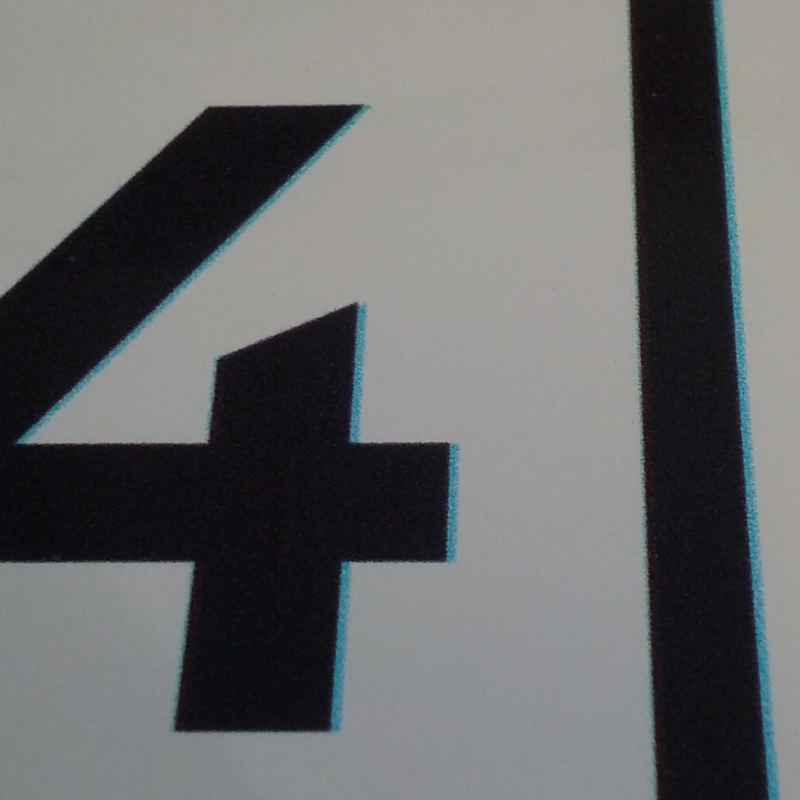

Is there a bad head? Also see pic #2. Supposed to be all black.

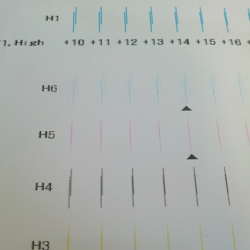

In pic #3, what is wrong with the black reference lines?
Thankful for any help!
/Toby

I have yet to have a bad head on our XC-540 (knock on wood). Our test prints have never looked like that. Maybe there is a hair or fiber on one of the heads. Do a manual cleaning and take a swab with some cleaning fluid and gently.....very gently wipe the head. Only use one swab per head so that there is not ink cross over. Do another test print and see what it looks like. That's all I got.....if it does not work, you might have a bad head, or maybe some of the others on this forum might know whats going on.
meritan
I have the same issue with my XC 540, Light Cyan and Cyan have the same look like your post, I make some cleaning but nothing change
CS-SignSupply
Cyan and black both problematic.
Have you had a tech diagnose it? I would do an Ink Fill Pattern test from the Service Menu to get more information.
What do the actual Nozzle Test prints look like?
